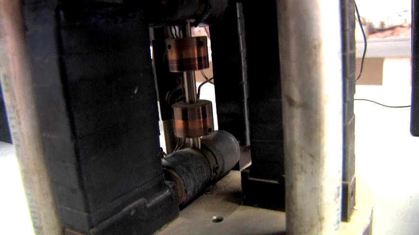

                        FWIW, here is a screen shot of Bedini's model taken right from the DVD. It's a close-up of the slip-rings. You may want to adjust the gamma level for clarity.
                        • They look solid to me.
                          You can view my vids here
                          http://www.youtube.com/SJohnM81
