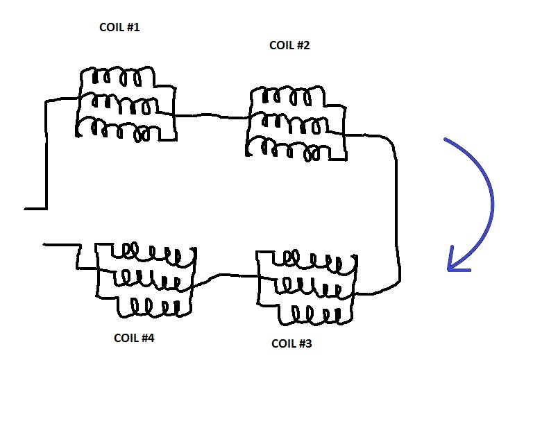

                Hi Timm,
                I have used 0.28mm wire for each of my coils. I haven't twisted them or done anything special. Each coil is a seperate trifilar setup with the wires joined at each end to form a parallel setup. Each coil is then connected to the next coil in a series setup. It is important that all the coils are wound in the same way, ie clockwise or cclockwise. Coils # 3 and 4 are then simply rotated upsidedown. Each coil has approximately 800 turns. The total resistance when they are all connected in series is 17.5 ohms
                I've attached a pic to make it clearer.
                As far as my mechanical problems go, I have ordered all the new parts and am now just waiting impatiently The stuff should arrive soon enough though.
                Cheers,
                Steve

                  Thanks Steve,
                  So for clarity, looking North to South across the pole piece, they are all wound the same (CW or CCW).
                  And you followed John's diagram in EFV10 exactly, and didn't flip the bottom rotor to make a Z pattern per Kromrey's patent.
                  My last few parts should be back from the machinist by weeks end. Hopefully we can compare notes soon.
                  Timm

                    Hi Timm,
                    I followed Bedini exactly. Totally ignored the wiring diagram on the patent. It didn't look right to me anyway.
                    If you imagine winding one long coil. Cut it into four pieces, then rotate the last two upside down. That's what I've done.
                    I should get my redesigned coil cores and covers back tomorrow. After that it's off to the winder to get them wound. Hopefully for the final time!
