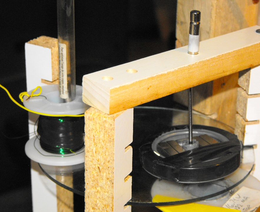

      Gentlemen, I have experimented successfully with non shperical satellites and I think there is room to advance along these lines.
      The apparatus consists of a test tube, glass (careful) or plastic, of a diameter that will fit inside a pickup coil.
      At the bottom of the tube, affix a small disk neo. You can tape it or glue it to hold it in place on the outside of the tube.
      Drop a cylinder neo (.25x 1" works well) into the tube that repulses the one you fixed on the bottom of the tube, so now you have a relatively frictionless magnetic support for the cylinder in the tube. It will work with the cylinder magnetized either axially or diametrically. (I suspect diametrically will prove out more efficient, please test to confirm)
      Now move the tube containing the magnets close to your spinning rotor to start it rotating. Once it cogs you can back away and extend the distance out to the limit or your rotor field.
      Now slide the tube with the rotating cylinder right inside the pickup coil and your generator is in production. Repeat as necessary to put the electric company out of business.

            No time for a video today, but here are a couple of stills to get you interested.
            Cylinder mag needs to be long enough that it can't turn and snap to repulsing magnet. i.e. length must be greater than diameter of test tube. I have actually run this setup, so it's not a theoretical discussion but longer or shorter cylinder mags may work better, still to be tested.
            I agree satellite speed is dependant on main rotor speed, so I will argue that this type of satellite should be faster than orbiting spheres as they describe a much larger diameter during their roll around a cup. Maybe not so if spheres are spinning inside a pickup coil, however, this setup permits much larger/stronger magnets to be rotated inside a coil and so should generate greater output. This setup also permits infinite experimentation to optimize pickup coil location as satellite can be physically moved inside, outside, up, down etc. and keeps rotating, seems more difficult to manipulate shperes and keep them going consistently.
            It cogs up and starts up easily just by moving it close to the main rotor, no hand spinning required, and the axially spinning field may be beneficial to generating higher volts as well, (not tested yet).

                • @el-tigre: Thanks for the pic.
                  It is more clear now. I have not considered that the cylinder is inhibited to turn around by the tube walls.
                  You convincingly argue that this would allow much stronger and bigger magnets with the benefit of pretty much no friction.

                    Yes, the neo cylinder in the tube cogs up with the spinning top and rotates very fast. When in rotation, it continues to touch the tube and the rotation looks like the original snake egg mags X shape orbit. A diametrically magnetized bar I tried rotates more upright. More experimentation required to see what is optimum.
                    I'm speculating this will be a good dc generator design because the single polar magnetic field can be made to follow an eliptical orbit right inside the pickup coil. (like stirring a spoon in a coffee, the handle does not get wet)
