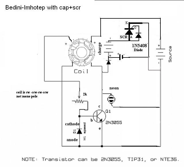

I'll see what difference comes from this. Thanks for the ideea. Can't do it directly with the SG because the wheel is too little and has no use for the timing.As for the solid state, do you have any ideea why it stops oscillating every time I connect a cap or battery? Can't start the self-oscillation otherwise. As soon as I have a load, nothing happens. I tried a range from 1-100K for the base resistor. Nothing!
I have a 50K pot in series with a 1K pot and a 10 ohm pot. For fine tuning. Without a load, oscillation starts at 3 Kohm.
