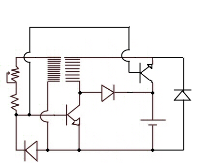

[ATTACH]282[/ATTACH]
anyways heres my latest i got no multimeter( hopefully will arrive tomorrow) so i cant test it yet its 4 power one trigger 200' coil
trifillar and litz

that's very interesting... did you read a post i made earlier about what i thought makes the transistor turn off to allow multiple pulses per magnet? I could be wrong (not being an electronics boffin) but as i understand if you have a standard bifilar coil with both wires wrapped the same direction and then pulsed a current through one of the coils a current would be induced in the opposite direction in the other wire. Is that right or have I misunderstood?
it could be that instead of the recovery coil being wrapped in the opposite direction, the diagram implied that the current flowed in the opposite direction?

The dot at the bottom of the recovery winding indicates that it is for taking the spike when the field collapses in reverse polarity and the North is at the bottom.
Even if you have a 1 wire coil and apply power...during the applied power, you get counter efm coming in the opposite direction because of Lenz's law. After the coil is turned off, the loop is open and all the work that went into the pulse comes back converted back to voltage potential. The collapse spike is not the counter efm but happens afterwards.Sincerely,

if not how does the transistor turn on and off multiple times per passing magnet?I can't find any where that says what this diode (1n4001) is for but am i right in guessing that when the power coil fires, its magnetic field induces a current in the trigger coil in the opposite direction to the current induced by the magnets and thus quickly turns off the transistor as soon as it opens which results in the sharp pulsing? ...
...and allows for multiple pulses per magnet.Last edited by Sephiroth; 12-17-2007, 09:31 PM.
