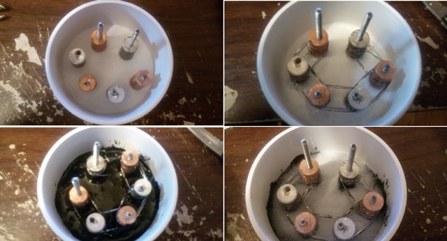

    Well, it didn't turn out as I had hoped, but this is my latest attempt at creating a crystal cell that produces more than 1.5v... I was actually hoping for at least 3v, but that didn't happen.

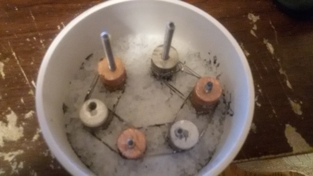

    I started by mounting several oxygen free copper rods and magnesium rods into a 3" PVC sewer cap. I used superglue to hold them down, then mixed alum and Elmer's glue to coat the entire bottom.
    I then proceeded to use A1 Kanthal flat resistance wire to connect the anodes/cathodes together... Hoping to produce more voltage in a single unit instead of hooking several batteries together, plus hoping to produce more amperage by using resistance wire instead of copper...
    I then mixed ground activated carbon and mixed it with sodium silicate solution to add a small layer to the bottom...

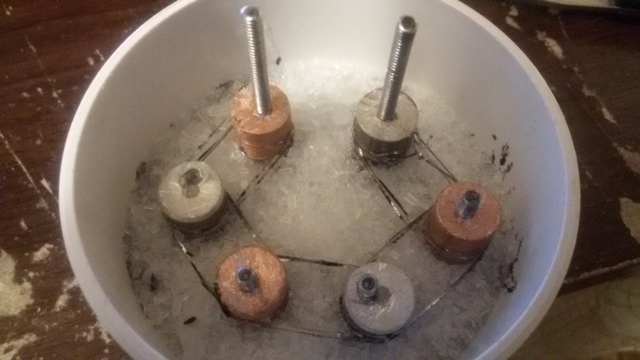

    Then I sprinkled alum on top of the carbon...
    Then some epsom salt...
    Then some Rochelle Salt crystals that I made...

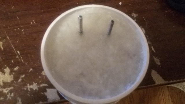

    I then created a mixture of Borax crystals, Alum crystals, Rochelle crystals, and potassium chloride together with some sodium silicate solution and mashed it all in as tight as I could....
    I them sealed the top with a 3" sewer cap plug. I used hot glue to seal the lid down... It is allowed to vent through the holes that the 2 posts are coming out of...
    I attached an external power source to set the polarity charge on the battery for a few minutes and then let it sit. At the time of this post, the unit is only producing 1.168v @ about 40mAh.
    I will have to wait a few days to get a true reading as the sodium silicate cures and fuses it all together... But I am a bit disappointed at the initial readings I'm getting from it.

            When you have multiple + and - electrodes in the same base, they can short together a bit and decrease what you get at the ends. It's usually better to isolate each + and -, might get more voltage and current for the same materials.
