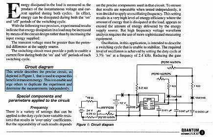

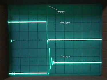

              Now for a scope shot. Using the text description I have duplicated the circuit in Toto!. (Not the Quantum diagram).
              The attached scope shot is what I see and it does not show an oscillation in the Gate. There is a worthless spike on the Gate, but the Drain is not abormal for what we are using.
              I am using the correct components. Should I order more? Is this like my Exciters where only the MPSA06 from certain vendors work?, or is this maybe a layout problem? Like some parasitic C that causes the oscillation?

                Why don't you duplicate the circuit IN TOTO like you say, and use the PUBLISHED CIRCUIT of Rosemary Ainslie, including HER published 555 circuit? Otherwise you aren't doing a replication, are you?
                Hint: if you DO use her circuit, exactly, you will be able to duplicate her heating results. If you continue to use a FG, or some other 555 circuit that actually does produce a 3.7 percent ON duty cycle, you will NOT get the heating in the load that Rosemary got.
                Go ahead and prove me wrong.

                  We are at the point where somebody claims to get a certain result using a definite specified circuit. The circuit is built and performs like the somebody said--it heats the load, etc. BUT it turns out that the circuit as specified cannot produce OU because it doesn't produce the duty cycle that the first somebody said it does.
                  So the conclusion that you seem to come to is that the original circuit as printed, over and over, is WRONG and isn't what was used to produce the results in the first place. Even though the results produced by the "wrong" circuit, in terms of heating, are actually right....
                  Come on, this makes no sense at all. If the circuit is a misprint it would not work at all or it would produce some random combination of frequency and duty cycle. If the circuit is built as the diagram shows it definitely does produce the heating claimed--it just doesn't produce the OU numbers because of the duty cycle.
                  So the error MUST be in the interpretation of the results. The mistaken duty cycle, from the circuit in the diagram, was used to produce Ainslie's heating results, and the MISTAKEN duty cycle figure was used to produce her COP>17 figure. Nothing else makes sense--unless of course I am wrong about the duty cycle that her circuit produces.
                  Why doesn't anybody just put the silly circuit together and check it? Are you perhaps afraid of what you might find?

                    I have a problem in the accuracy of the diagram of the 555 PWM that is shown in the Quantum 2002 Article, my primary concern is Pin#6, the Threshold. It is connected to nothing but the capacitor as indicated.
                    (snip)
                    I doubt very, very much that a number of people made the same Electronics 101 mistake.
                    I'm just re-quoting you to make the point that you might not always be seeing correctly what is right in front of you.

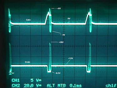

                          Well after going through a number of the same brand MOSFET I found one that under certain conditions would produce an oscillation, although it is orders of magnitude higher than described, yes of value in seeing how the LR reacts under the conditions.
                          The scope shot was adjusted to separate the gate and drain traces so they can be seem more clearly. There is another shot on my web page for this attempt if you want to follow it. It can be reached from my index page.
                            These of course are very similar to the shots I posted last week on OU forum.
                            I note a couple of things: First, you don't seem to be using the voltages specified by Ainslie. Second, if you are monitoring the Source and Drain pins of the mosfet you aren't at the same places that Ainslie was monitoring. This will make a difference. Third, if your bottom trace is set at 20 volts per division, the bottom valley should read "2 volts" not what appears to be "0.2 volts" as your annotation appears to show. Of course your scope is a lot fancier than mine so I might be wrong here,,,
                            And fourth, these oscillations are normal, they don't look like the "random chaotic" oscillations that Ainslie describes. Of course if you use the actual Fluke 199 scope you may see some false triggering....

                              I refer to my posts 77 and more so at 81, as you have found Dr. I also found that you can use the same mosfet number and maker and not all work the same. If this is the case and we want to produce a salable model for all to use, how are we going to do it, there are so many, "works only if's", to produce a production model will be so expensive due to a mosfet that has a 1 in possible 1000 flaw, which normally is not a problem, but in this case is a must.
                              I have moved on to look at how to produce the oscillation required without the need for the mosfet, possibly in 10 years time, if I am still around , I will have the answer

                              • I see that it is futile to attempt to have an actual dialog or discussion on this forum, so until that situation improves this will be my last posting.
                                Here is a summary of my findings and opinions in this matter:
                                1) The Ainslie circuit as described in the Quantum article produces a 96.3 percent ON duty cycle at 2.4 kHz and with the component values specified cannot be made to produce a 3.7 percent ON duty cycle.
                                2) This high ON duty cycle produces heating in my load that is similar to the heating reported by Ainslie in her papers.
                                3) When the circuit is triggered by a function generator or a properly-made 555 circuit at a true known 3.7 percent ON duty cycle, no heating of the load or the mosfet is evident. This finding seems to be independent of the MOSFET used, although I have not been able to find the exact mosfet she used, the IRFPG50. I used IRFP450, 2SK1548, 2SK5138. All gave similar results, with the exception that the IRFP450 showed long turn-off times on the order of 2x gate pulse width at the short input cycles.
                                4) All mosfets could be made to show inductive spikes, ringdown and parasitic oscillations, but none showed "chaotic" or "random" oscillations as described in the Ainslie papers. It is my opinion at this point that she was seeing false triggering of her oscilloscope and interpreting it as random oscillation.
                                5) Because of the error in duty cycle, the power calculations in the Ainslie paper, which were done "by spreadsheet" (instead of by the Fluke software integration routines, apparently) are also in error.
                                6) It has been maintained that my findings show, not an error in the OU calculations, but rather an error in the published circuit diagram of Ainslie. I reject this explanation because an error in the diagram would not have produced a functioning timer, and for other good reasons.
                                7) Regardless of whether the error is in the diagram itself or in the duty cycle used in the experiment, the paper is wrong and should be corrected, if the diagram is at fault, or retracted, if the duty cycle (as I believe) is at fault.
