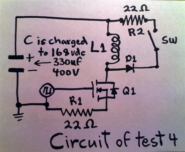

Hi Rosemary,Originally posted by witsend View PostRegarding gotoluc's circuit - I'm still struggling to understand it from the video. Sorry. I just do not find my way around these things with the ease that you guys have. I'm referring to the circuit with 'no bulb' and same resistive loads, only because Hoppy recommended 'less variables' and because I understand it better.
So - it's basically my circuit but the 'inductive resistive load' is replaced with a single wound inductor in series with a 22Ohm resistor, call it R1. The base of the inductor goes to the switch. At the junction of the inductor and the switch is the 'feed back' diode which has a second 22 Ohm resistor in series. Call that resistor R2. This, 'fly back' or 'feed back' diode, in turn goes back to - either 1) the junction of the wire between R1 and the inductor or 2) straight to the source - parallel to the R1?
sorry for the delay. Like I said! I was out for most of the day.
I thought you were asking about the circuit in the new video! I now see you were inquiring about test 4 video.
I made a schematic of test 4 circuit. I also just saw for the first time your schematic. Looks like the same thing
... the only difference is your flyback is created by the small inductance of a heating element and mine by a coil. My original circuit was less the resistors as I was demonstrating the effect of just flyback re-circulated to the coil that created it. I added the resistor after seeing your topic to see how it would perform. I think it's doing very well at producing heat also.
Anyways, you should see the circuit attached below.

Hi folks, Hi gotoluc, I did not realize that is the way you had the output resistor within circuit gotoluc. I was using Rosemary's circuit which does give more heat because I tried both ways although not sure if the coil field would reduce. Here is a cad pic of the circuit I've been using, which I believe is the same as Rosemary's circuit.

Hi SkyWatcher,Originally posted by SkyWatcher View PostHi folks, Hi gotoluc, I did not realize that is the way you had the output resistor within circuit gotoluc. I was using Rosemary's circuit which does give more heat because I tried both ways although not sure if the coil field would reduce. Here is a cad pic of the circuit I've been using, which I believe is the same as Rosemary's circuit.
humm... you're right!... I see now there is a very big difference. In Rosemary's circuit the resistor causes resistance during the on pulse, which means it will be heated by the supply energy and then heated by the flyback when it switches off. In mine, I only wanted the flyback to go though the resistor.
Wow SkyWatcher, thanks for bringing my attention back to this since I thought that both circuits were the same.
If I were you I would think about this as you maybe getting more heat in Rosemary's circuit but if you think about it you are paying for it since it comes directly from the power supply during the on cycle.
I chose not to do that since flyback effects is what I've been studying.
Anyways, do what you think is best.
Luc
Skywatcher and Luc - you both use inductors. The point about my little test is that the inductor and resistor are the same thing. In other words I use an inductive resistive load.
But having said that I really prefer to see what you're testing - simply because it brings up new perspectives on the same thing - being the flyback principle to enhance efficiency - or as gotoluc aptly describes it a 'reticulated current'. That's just so well put. And it's important that all points are argued. So please don't change it unless that's where your own logic leads. To explore your own questions is far more creative and therein you'll add to your own knowledge. Personally I just love asking questions and clearly you guys are of the same mindset.
My only ask is this. I'm not usually 'slow of thought' - but when it comes to circuit analysis - I go into gridlock. The sketches provided by you both I can readily undestand. The circuit diagram described by Groundloop I cannot understand beyond the actual input and output points plus the interactive point with the switch. If you reference a circuit please may I ask you to indulge me and do a sketch if possible. Like you've done. And then, if you change the circuit you can just reference it on the sketch. I think this is really all that even Dr Stiffler needs. Else I simply cannot understand what's being referenced and for that matter no-one can unless they're familiar with your test set up. I'm still learning here.
