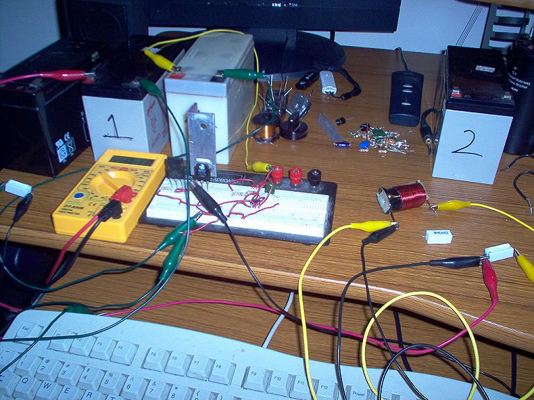

Hi Rosemary and everyone,
Since my pulse circuit is basically using the same 555 timer that you are using and Groundloop was very limited in time he sent me the link to the circuit he has posted before.
the only difference in my circuit is I'm using an IRF840 as switching mosfet and the capacitor used to set the frequency around 665 Hz is .001uf. I also used a 1Meg pot (for duty cycle) since I had it on hand and found it to have smoother adjustment at 10% or lower duty cycles.
My coil is 800 feet long or 244 meters of #20 AWG or .81mm magnet wire wound on a spool used for mig wire welding equipment that has an 1-1/4" or 32mm opening in the center, a total of 4" or 100mm in spool diameter and a width of about 1-1/2 or 38mm of open area to wind the wire between each ends of the spool. The coil has a DC Resistance of 8.3 Ohms and Inductance of 63.5mH. This coil is the best performing @ 665Hz of all my 10 or so coils available for testing.
The recirculating diode are two MUR420 in parallel soldered to the negative side of the coil and directed so positive can flow back to the positive side of the coil when the collapsing field occur. I have a switch between the positive side of the diode and coil in order to observe the effect of not recirculating the collapsing field. My power supply is 120vac through a FWBR to a 400v 330uf capacitor. Nothing more I can think of.
If someone has the ability to make a complete illustrative kind of circuit (non EE style) of all the above information it would help beginners or non EE trained to replicate this also.
Thanks for your interest in this simple circuit.

Hi folks, Awesome work Gotoluc. I have run some tests with the same circuit I used as posted in post #14, however I used a 5W, 1ohm resistor and also added one on the input line as Gotoluc did. Also I used different frequency and duty cycle. Freq. used was 1.3khz. @ 9% duty cycle w/ 12V @ .18A input.
I am seeing the same results that Gotoluc is claiming, the input resistor is barely creating any heat at all, while the output resistor is much warmer, probably 3 times or greater in temperature. I still have to get the cheap parts to cobble together a simple thermometer based calorimeter so numbers are visual. So there ya go, it seems if we get the freq. and duty cycle right, things happen. heres a pic of my setup
