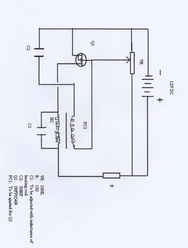

      Circuit Not Tested
      Here is the circuit, which I think will need more work with experimenting. How it works is the heating coil and C1 is an LC circuit, the pick up coil controls the mosfet at the frequency of the oscillation of the LC circuit, VR is for the set point of the mosfet. Between VR and the positive rail should be a resistor of about 10K, which is not shown, to protect the mosfet. When the mosfet is off, C1 supplies the current, when on the battery supplies the current. There is no switching of polarity on the heating element coil, no diodes are needed.

        Michael,
        Yes, your circuit idea should work. There is also the simplest version of the circuit, which is just the Inductive Heating Element in a tank circuit with a corresponding Capacitor, driven by a variable AC sine-wave Power Supply at the natural frequency of the resonant tank. Also, if the components were large enough, the system could be tuned to run at 60hz. Then, there would be no local electronic components at all and the Heater Coil would simply run as an "idling" inductor with a local power factor correcting capacitor.

          Thank you Peter for the encouraging remarks. I was thinking, for this circuit, as a test bed only at the moment, as I posted a little bit before, my concern is the the goal posts move as the heating coil warms up and this is a form of tracking this, all be it very basic.
          @Dr. Stiffler
          I hope you do not mind me saying this, but I have been playing around in my mind about using your SEC, I think this would be very interesting but I will leave that up to you as I am sure you can see the possibilities more than this novice. If and when we have a good sound working model then the rest would be my forte in heating something other than water and gain real power for your money
          Mike

                  Hello all,
                  I had some time to look in depth at the original circuit.
                  I have redrawn it differently just for fun. See attachment 1.
                  A bridge rectifier is now in place of the power supply, so consider the circuit being powered from AC . I removed the 2 shunts, and also removed D1 & D2 which are now replaced by the bridge.
                  The diodes are Shottkys, to be able to switch efficiently at higher frequencies.
                  I also added a coil in series with the heating element, because commercial elements I've got here are very low in inductance.
                  Of note is that the main difference between this circuit and a standard boost converter is that in the boost, the pulse of energy which is sent to the coil to magnetize it, is not available to the load. It is wasted to ground. Here however, that magnetizing pulse goes through the heating element.
                  Then of course, the flyback pulse continues heating the element further..
                  I then made another drawing, with a second element (HE2), that becomes active during the duration of the flyback pulse. According to armagdn03, additional impedance during the flyback pulse would be beneficial. If we make this impedance from an additional heating element, I assume the results would be increased efficiency. See attachment 2.
                  Of course, in this circuit, we're not running in resonance mode. It's just basic pulsing of a coil.
                  No tests have been made yet, I don't have all the parts I need right now. I would be interested in hearing what you think of this scheme.
                  The third drawing is the "What if..." option
                  Instead of the second element, I put another coil which is in fact the secondary of a transformer. The primary is L1, the first coil. This could be a bifilar wound coil.
                  The way it works (if it really does !) is that during the charging of L1, the current of L2 is blocked by D1.
                  Then, during the flyback pulse, L2 would be (supposedly) aiding L1, being of the same polarity. See attachment 3.
                  Would that really be worthwhile ? I have absolutely no idea ! Maybe there would be a way to integrate a capacitor to make it resonant, but I don't think it is possible to combine the 2 modes (switching & resonant) in the same circuit.
                  Anyway, do you think putting a coil in series with the heating element as I have done in the first circuit, is a good solution to transfer more energy with each pulse ? I understand that the coil should theoretically have the lowest possible resistance, however as the goal is to make a >heater< unit, thermal losses in the components are irrelevant aren't they ? Or maybe they are, because it would reduce the efficiency of the whole unit...
