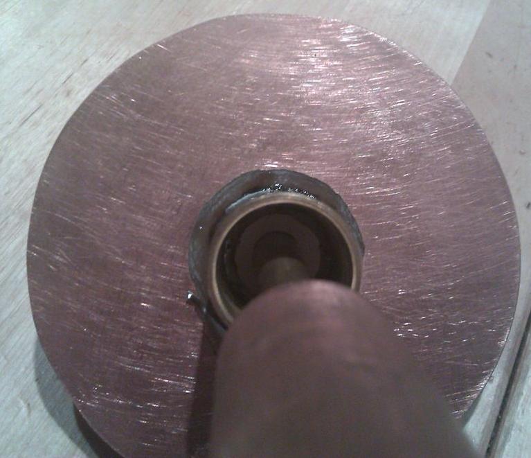

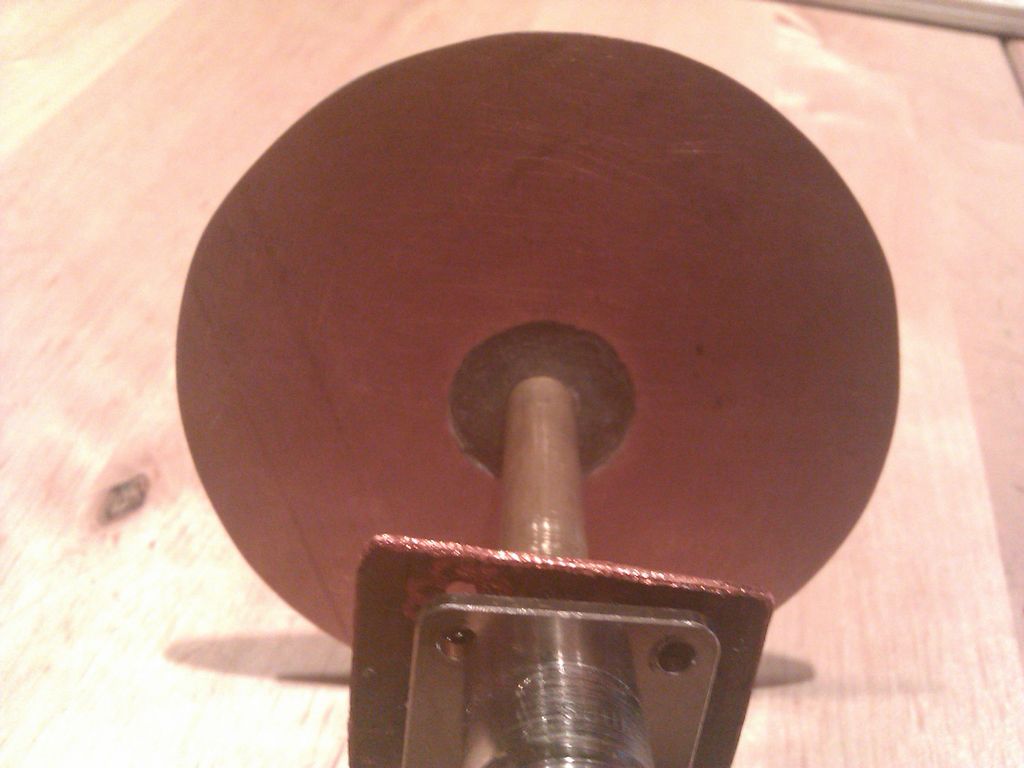

                We also performed some measurements with an SWR meter on my latest antenna, and it was not good enough by far. I suspect the hole in the lower copper plate of the PCB is too small, so I scratched away some more copper at that side of the PCB. I also soldered some bolts in the bottom of the wave guide, so I can easily mount (and fix) the probe antenna into the wave guide. Yesterday, I mailed it to the radio amateur that is helping me with this, so he can measure the current antenna the coming days/weeks. Hopefully I got it right this time, but we will have to wait and see.
                Update: See the left one of the attached pics for the hole I am referring to. ( more pics of antenna here: Dropbox - Photos - Simplify your life )
                The hole in the copper on this side of the pcb was the same diameter (28 mm) as the outer diameter of the ring on the other side on which the balun section of the dipole is mounted. (Attached pic at the right). The copper ring on which the balun section is mounted has an inner diameter of 18 mm and an outer diameter of 28 mm. Around this ring, a ring of about 4-5 mm thickness is scratched away in the copper, so the outer diameter of the isolation ring is about 36 mm.
                I suspect the matching of the outer diameter of the ring where the balun section is mounted on with the diameter of the hole on the bottom side of the pcb gives too much capacitive coupling between the dipole and the wave guide, so I made this hole considerably bigger.
