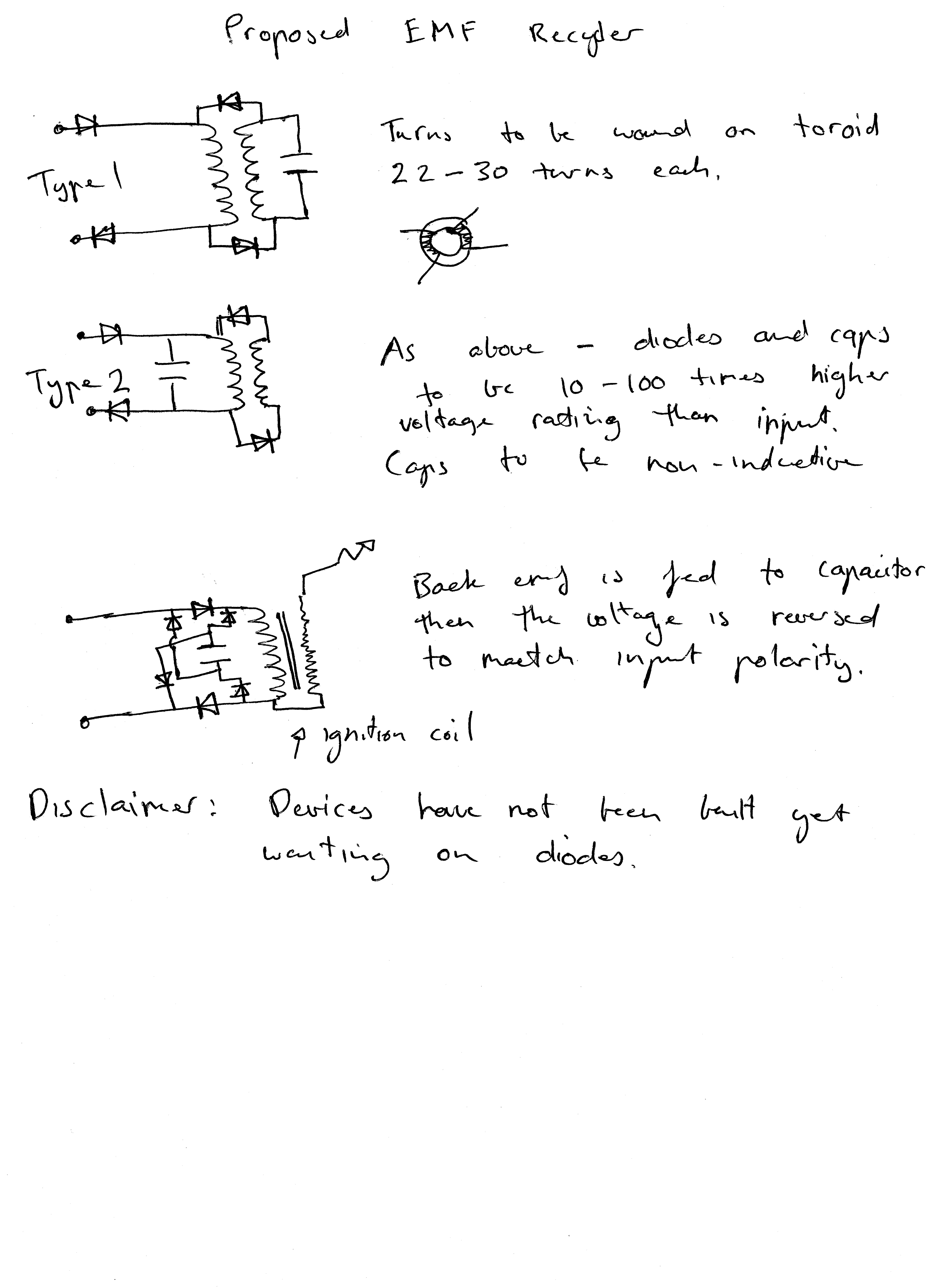

    I was watching Eric Dollard's new video I purchased on the Four Quadrant Theory. He referenced a book about Tesla (Secrets of Cold War Technology).
    That led me to watch some Lindermann videos. Tying it all together I gathered that Tesla's impulse electricity removed the magnetic component from the dielectric component.
    I came up with a theoretical circuit I am yet to build I was hoping other people would try it out in the mean time (awaiting diodes). I hope it will recycle the EMF and re-introduce it in the circuit and remove the parasitic oscillations.
    Eric's statements that Tesla created a machine that could push with out needing something to lean on made my head spin. Once my head stopped spinning at 3300 rpm here is what I got.
    It is like a swing. The pushes hopefully increase the energy in the circuit instead of dissipating or fighting itself.
    I am basically an electrical dunce so if it is incorrect please forgive me.
    Another disclaimer this is at this point all speculation at this point.
    -Wil

      Diodes are generally not sensitive to frequency, so what kind of diodes are you planning to use?
      It seems obvious that one side of the capacitor will accumulate a positive charge, even if the input is AC. In the third circuit you have provided a low resistance path that will tend to drain the capacitor.
      Consider the various input wave forms: Sine, continuous, pulsed DC, etc. You still have a lot of variables to manipulate.

        I want to run pulsed DC through the circuit. My original intention was to run an ignition coil and make the sparks as big as possible by fully using the reverse EMF. I hope to make an electrical analog of a swing.
        At this point I don't know if it will just neutralize itself by discharging through the diodes.
        As for the diodes I just ordered a bag of 100 mixed diodes (1N4148/1N4007/1N589/1N5399/FR107/FR207/1N5408/1N5822).

          Hey guys just an update. I still don't have enough diodes to build the full version and I have no way to test them even if I did (no current meters or oscilloscope).
          So I chose to build something I could see the results in - ie. frequency change. So I build a joule thief with 2 coils and then added the EMF recycler.
          When connected the frequency doubles almost - 44kz to 80khz. I still don't know if this is useful or not but it is a neat way recover some of the dissipated energy and increase the frequency.
          Does anybody know theoretically what the heck is going on? I gather inductance is being lowered by reducing the EMF. But how exactly I am not sure. Hysteresis would mean the EMF being reduced (reused?) would affect the energy going in (affecting the past). But this is too complicated for my mind.
          Also the L3 winding has the most turns so it should have the greatest inductance....
          When I build the bigger ones I will let you guys and gals know.
          PS I am not too sure about the diode symbol so I checked manually and there was definitely no way current was passing through the diode until the unit was oscillating (EMF current was passing through but not current directly from the battery).

              I'm surprised that it decided to oscillate at all. It's probably the internal capacitance of the 2n3055 power transistor that saved the day. It's also going to be thermally unstable.
              The third coil is loading the "collector capacity" and thus changing the period of the cycle in some way.
              Check out "blocking oscillators" and "relaxation oscillators" and pulse generators on the net for a better circuit to use.
              Fast rise/fall times in a pulse will give the best results in a regenerative setup like that.
              V = L dI/dt such that the inverse polarity voltage in the rapidly collapsing field will be >> than Vcc. They use a concept like this in boost regulators but have nothing to do with "OU".
              In the end, you will undoubtedly discover that there is very little "free lunch", but you can have a lot of fun learning.

                @speakerbox, an inductor resists sudden changes in current flow. The changes in current flow happen quite quickly if the inductance is low. It happens so fast that you will almost always need an oscilloscope to visualize it. The thing that "explains" this behavior is the Back EMF or Counter EMF which changes in time in the same time frame. So, the instant you apply a voltage, a.k.a. EMF, to a coil you have an instant CEMF that prevents the current from instantly rising to the Ohm's law current based on the DC resistance of the coil. As time unfolds the current through the coil rises until the voltage is removed. This is because the CEMF becomes less over time.
                In the Joule Thief the base current in the transistor cuts off the supply voltage current. The magnetic field that has built up begins to collapse. The current, remember, does not want to change. It continues to flow in the same direction. It can't flow through the transistor. The transistor is off. The electrons build up with nowhere to go. You see this as a rise in voltage which eventually will dissipate through the diode that is put in the circuit to handle this eventuality. The voltage and current is sometimes called the CEMF or Back EMF. In fact, it is almost always given that name. When you really understand what is happening, you will think that name is inappropriate. That is my opinion, since it seems everyone continues to use the same old terminology. In my opinion, again, I think it is completely backward and totally confusing. Still, using a diode or some other mechanism, you can direct the built-up electrons somewhere you can put them to use. For example, you can use them to charge a battery. Therefore, in place of a diode you can place a diode and a capacitor or a diode and a battery.
                This is kind of long, so I am going to cut off here. You seem to be interested in understanding, so I hope this is helpful. BTW, I think you will find the Bedini does NOT work like a Joule Thief. It works on a different principle!

                            L2 and L4 are DC offset, and form a capacitor. The pancake coils, are plates of a capacitor.
                            the impulses are discharging the capacitor alternately.
                            L3 is parallel tuned to the same TEM and LMD frequency.
                            If it is accomplished, I will make a proper video again, showing and explaining all.
                            That is an awesome collection of ideas. be sure to let me in on the set up when you can. This stuff interests me and somewhere alone the way I am sure you will make many more discoveries.
                            hats off to the digital hair pin
                            Also I would be wondering if you have done any combination circuits using differential or as we have been calling it a 3 battery circuit meaning recycled joules still running a load. According to some this recycle idea can bring up cop in a circuit if we could only figure out what is being said.
                            I still believe there is a combination of circuits that will be the gold mine.
