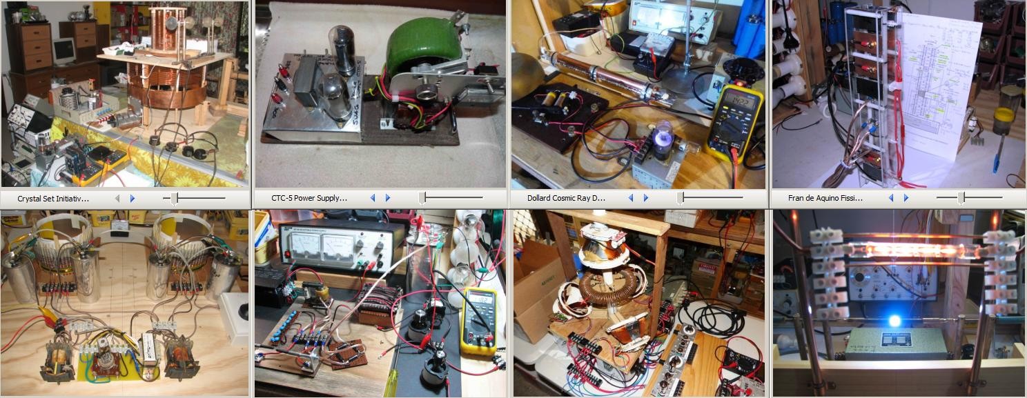

Name:	Energy Synthesis Montage2.jpg
    Smokey
    That's some pretty nice stuff you got going in those pictures. Keep experimenting, we need more people in the world who are experimenters, and less people that talk but don't act.

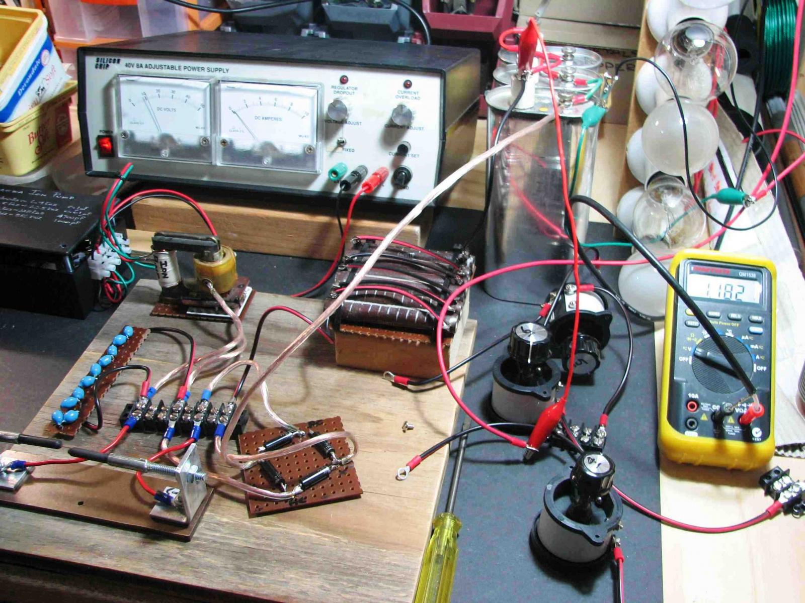

              When we discovered the plasma phenomena in the Impulse Discharge, I then set about attempting a down conversion from the storage capacitors (4kv) into a 240 volt power supply.
              First efforts were with Gas Discharge Tubes but all this did was burn them out - this is what Don Smith had used but was hopeless.
              A spark gap showed me that I could keep a 240v 100watt lamp glowing reasonably nicely but was most unreliable and that is when it looked capable of OU - about 2.5 watts in (12v @ 200mA) and 100 watts out - all analogue metering.
              Carbon tips being used here from D batteries and in there is another OU prospect in why it was that they stopped using carbon for anodes in large Tubes 805/813 etc and I still do not have an answer - Eric - anybody?
              The DVM is measuring voltage at the caps via a 1000:1 homebuilt probe and shows 1,182 volts:

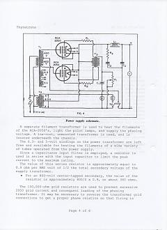

              This device was then put on the backburner in an attempt to discover a reliable means for the down conversion.
              Along came Eric Dollard and gave me some beaut Thyratron schematics like in the TMT Pulser (2050) and the Cosmic Ray Detector (OA4G) and pretty much there was my answer but still not finalised at the bench.
              Direction here is to disable the current pulser power supply HT and use the 600 volts from the storage capacitors to drive the system at 50 hertz into an output transformer for the 240 volts ac.
              There is a circuit in the RCA Manuals that shows a power supply using thyratrons (2050) and this kind of sealed the problem.
              This is from RCA Ham Tips Nov-Dec 1946:
              Also have plans to use the Tripler with the Flyback for 27kv and have actually done this but my records are incomplete and I have no idea why and requires a review.
              Lots of work still to be done here to simplify the circuit to make it reliable but the thyratron is an answer.
              There may be other alternatives and I am open to suggestions.
