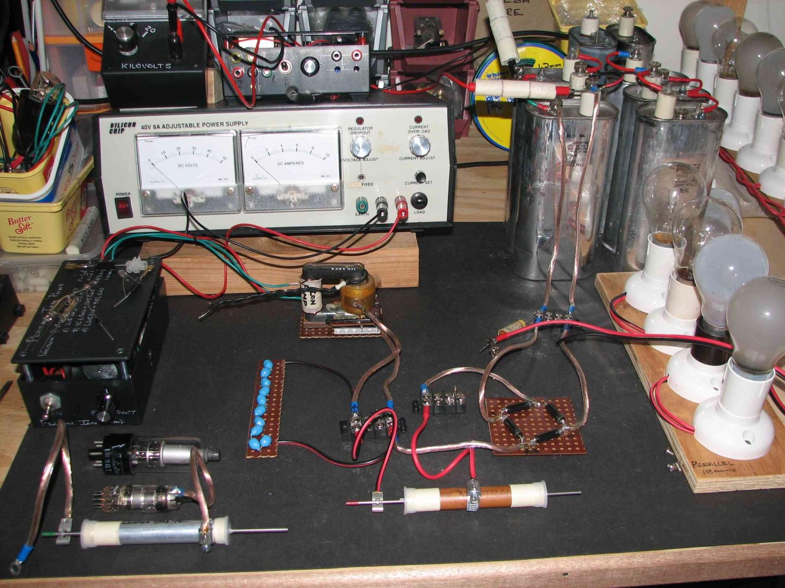

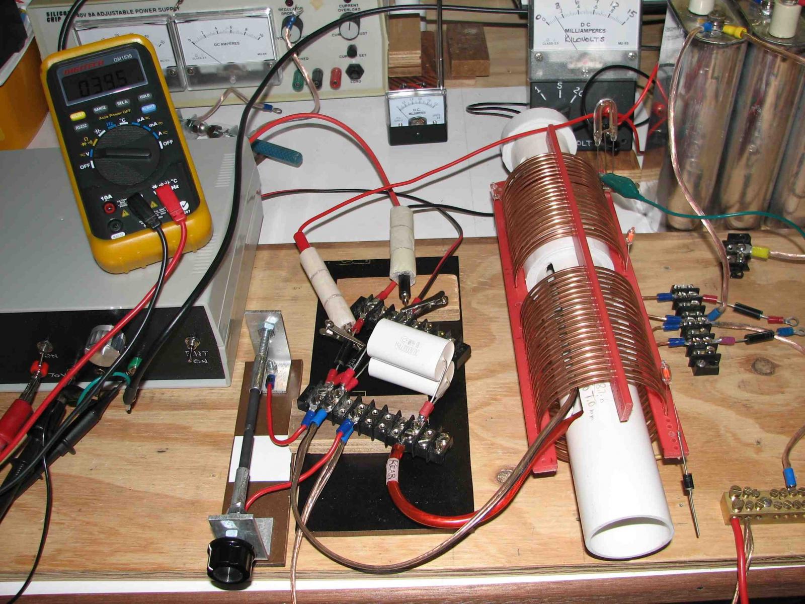

            Click image for larger version  Name:	Impulse Discharge at work.jpg Views:	22 Size:	277.6 KB ID:	496060
            'Impulse Discharge' was an accidental discovery when doing the Bruce Perrault Ion Valve and Don Smith's Flyback type research.
            I, at times do things a little different to the norm and do experiment as I experiment and in such, you get the Dollard 'out of the box' experience.
            I am using Bruce's and Bob Ianinni's Pulse Generator (Plasma Ion Pump) which I modified for a greater frequency range and works well with any Flyback and noted the frequency at the discovery was about 75.76 Khz. The ceramic capacitors are in series with the total measuring 19pF - 10 x 100pF.
            20 Kv Ceramics in series, I believe, also give you an OU burst, difficult to explain as do oil filled capacitors.
            The Spark Gap is using Carbon rods from ' D' batteries and as you can see, the gap is quite wide with the spark extinguished and a plasma connection instead - no noise, no maintenance, no light.
            A vacuum tube glass encased variable vacuum tube capacitor would be a probable answer here to the 1B22 but they are most difficult to come by today.

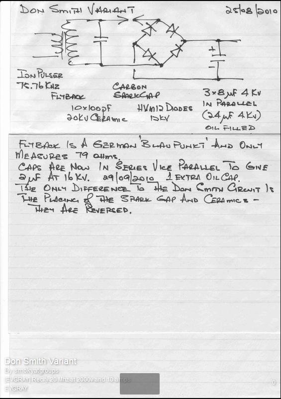

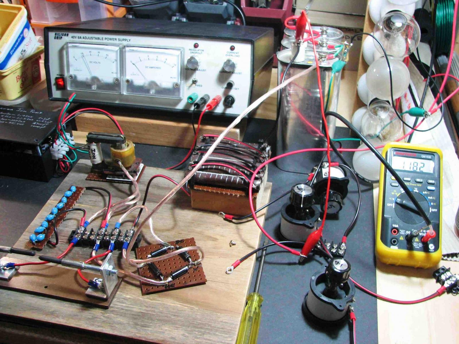

            Click image for larger version  Name:	Don Smith Variant circuit.jpg Views:	22 Size:	95.3 KB ID:	496059
            I am most fortunate in that in my early research years I did most of my purchasing from the USA of things that were simply not available here in Oz and that included all the good Tubes plus oil filled capacitors, HV Caps and Neon transformers etc.
            These capacitors are across the Flyback with the Spark Gap on one leg of the HVM 12 kV high voltage diodes.
            The German Blaupunkt TV Flyback is probably a 9 kV and uses a Tripler to get the required 27 kV. This is a future modification to triple the voltage but still awaiting the action.
            Philips and Blaupunkt in Australia would be like GE and RCA in the USA.
            Current at input went from 21 to 7 mA but as you can see the caps are holding 1.1 Kv voltage and continue to charge. Probe is 1,000:1.
            Caps are oil filled 8uF in parallel at 4 Kv.
            At this point I declared an OU success but the real problem was down converting (DC) what was stored in the caps to a useable 110/240 volt.

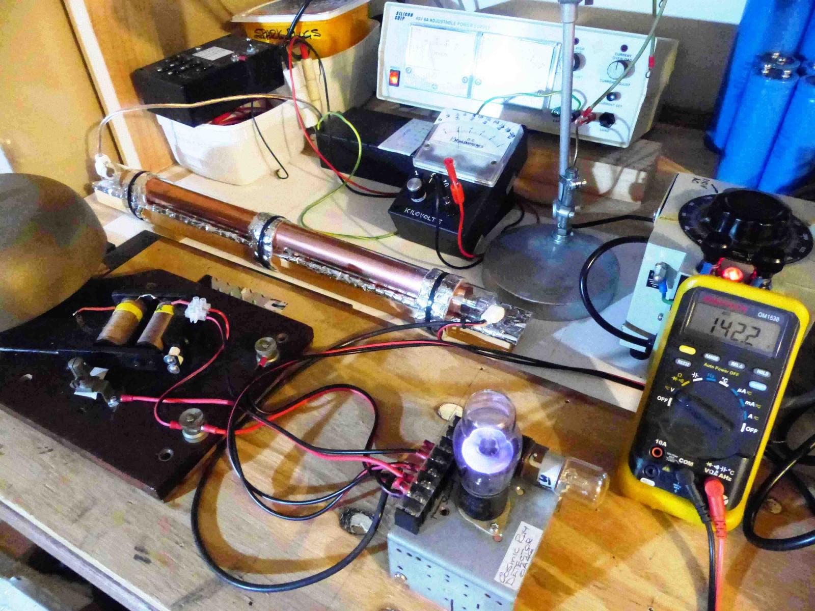

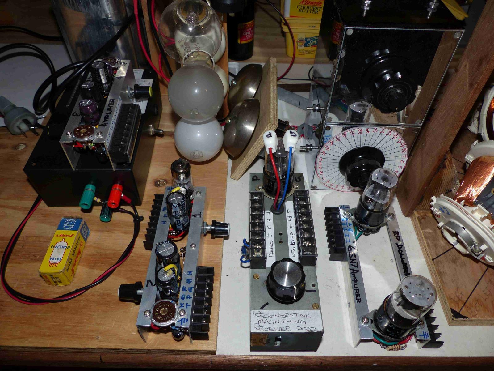

            Reason why I built the Cosmic Ray Detector (CRD)(OA4G) and the TMT or Crystal/Radio Set Initiative (CSI) Pulse Generator (2050) to gain further Thyratron experience.
            Click image for larger version  Name:	Dollard Cosmic Ray Detector working2.jpg Views:	22 Size:	268.8 KB ID:	496056
            Click image for larger version  Name:	Dollard TMT Pulser & Receiver & 6SN7 Amplifier2.jpg Views:	22 Size:	276.3 KB ID:	496057

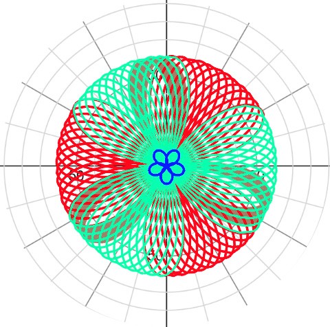

                            Click image for larger version  Name:	h1.jpg Views:	0 Size:	80.4 KB ID:	496392
                            I believe this identity is extremely important
                            as it relates to electromagnetism
                            and/or sacred/universal geometry.
                            I believe it solves a number of the outstanding Millennium Problems - certainly the Reimann Hypothesis,
                            thus I want an actual electrical engineer / experimentalist who knows the math to see it.
                            Please pm me so I can get it to you.
