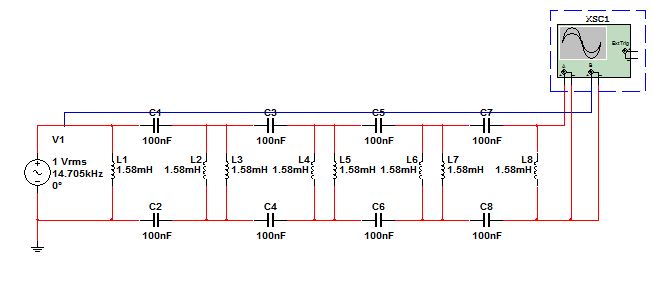

I have been trying to find an inexpensive model to examine ?
The latest Slayer coils are inexpensive and very efficient design that works and is available off shelf. ( Would this work ? ) I think it is interesting. I think his work also deserves credit is less shocking and lends itself well to proof and refinement of our math, also is another avenue to get repeatability in quantitative analysis out there that people have access to. The Dollard program is full scale and we should be honing our skills as the project moves forward.
Simulation of Naudin replication of Dollard transmission line has been awaiting subroutines awhile. used this to develope a transistor oscillator uses nichrome output coil to wave shape pulse to an asymptotic wave.Last edited by mikrovolt; 02-27-2014, 03:36 PM.
