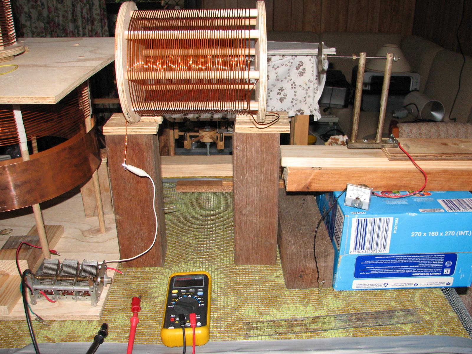

                • Extra Coil Test
                  Extra Coils Test:
                  Signal Generator:
                  Wavetek Model 191 Pulse FG 20Mhz
                  Frequency Meter: Sinometer VC3165 0.1 Hz ~ 2.4 Ghz
                  Extra Coil #1 14awg 54 turns (50.3 calculated) 'The 'Accidental Coil' as I was aware the Secondary and the Extra should be about the same length.
                  Adjust = 130mm 5.125"
                  Volts imput = 295mV + 10db output attenuation
                  Fpeak = 2369.5 Khz (1557 Khz *pi/2 = 2.445.7 Khz) close and needs to lose some turns.
                  Cvar = 300 pF
                  Height above Ground Plane = 12.75"
                  Extra Coil #2 21 awg 125 turns including 1 extra turn - Eric's Math which I am disputing.
                  Adjust = 65mm
                  Volts input = 820 mV + 10db output attenuation
                  Fpeak = 1024.9 Khz
                  Cvar = 267 pF
                  Height = 14"
                  Extra Coil #3 Same as #1 but 11 awg and 56 turns
                  Adjust = 70mm
                  Fpeak = 2650.9 Khz - needs to have turns pruned back to about the 50 and would also expect Volts to reduce as well.
                  Volts input = 780mV + 10db attenuation
                  Cvar = 212 pf
                  Height = 12.125"
                  Hands up those that can see the problem?
                  Some Math about 1557 Khz - what do you want to do?
                  Go to the high side of the 1557 or the low side where it is a cow to tune and you are working on the tail end of the Luminal wave and not at the beginning - See my drawing.
                  1557 *pi/2 = 2.445.7 where I am working.
                  1557 /(pi/2) = 991.2 Khz where you are working - see Extra Coil #2 at 1024.9 Khz - only a 34 Hz discrepancy.
                  Hands up all those that have produced the 1N34 pickup head into high impedance Headphones and are able to receive a signal through the air for nothing coming from your Extra Coil some 10 " away without using some large metal receiving antenna where I am using a pin head?
                  I repeat:
                  The Secondary and the Extra are the same length!
                  I have a working passive TMT, you don't!
                  All of this was displayed at 'n6kph' where you were supposed to be operating and now I feel I am just wasting my time here and you have the audacity to question how 'quiet' we all are!
                  I will set up some means of charting the Field Intensity Meter but the peak is of a high 'Q' nature and really is not going to reveal much.
                  Will do Secondary tomorrow after tuning # 1 and #3 for turn peaks for frequency match.

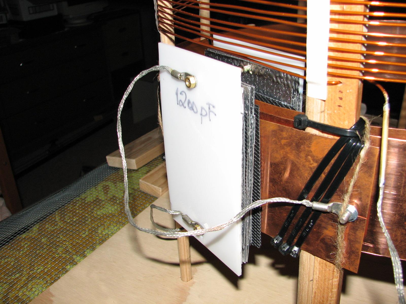

                  Last pic is of an integrated Capacitor into the Primary which I am not quite happy about and needs strap connections which I have not done as yet.
                  At least I now have tuning capability on the Primary.
                  Tried to put up full size pics but not obvious how that is done - Later.
                  Just feel I am wasting my time.
                  Smokey

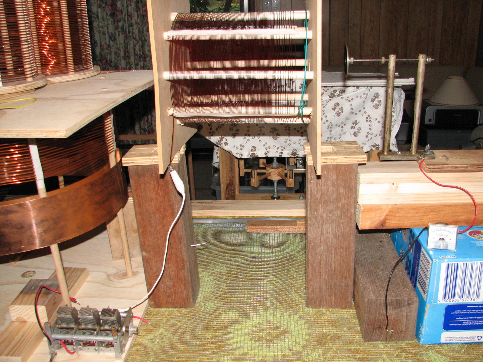

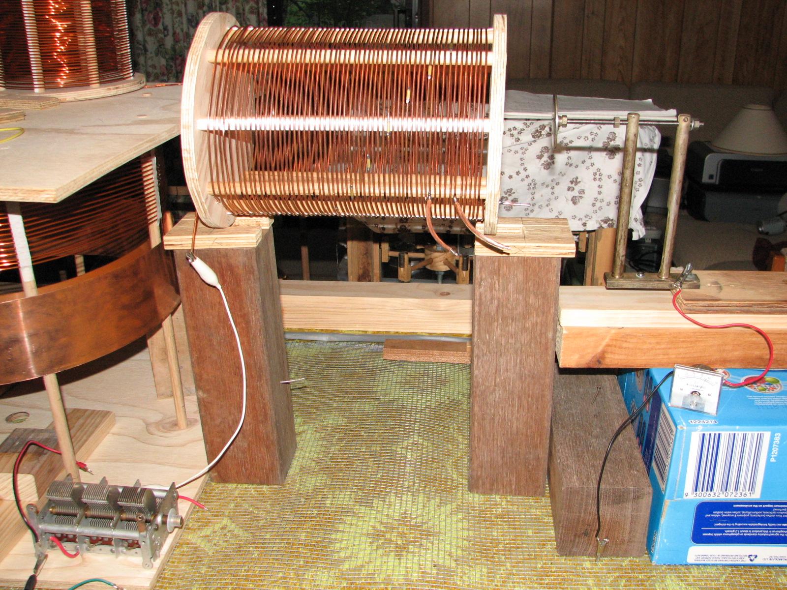

                  • Extra Coil Test
                    Had the pics in order but are not presented in that manner.
                    First pic is # 3 My 2nd
                    Second is # 1 My 1st
                    Third is # 2 Eric's Math
                    Smokey

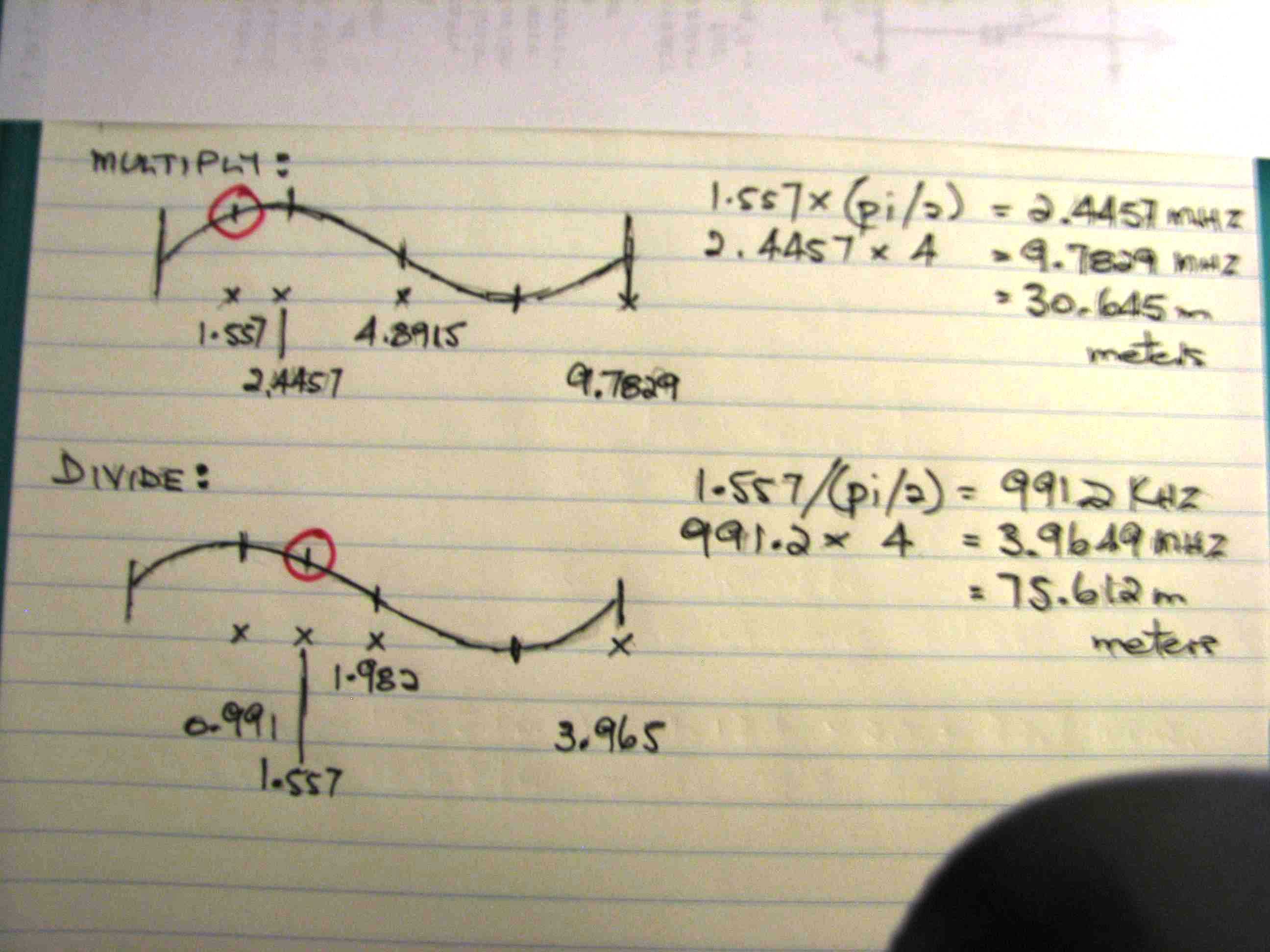

                            • Extra Coil Working Point
                              Attaching the drawing I made of the Luminal point where the Extra Coil is working or should be working at.
                              As you can see from the diagram, Eric's is before the frequency of concern where mine is after and also gives the correct length for the Extra.
                              Looking at this from what I presented earlier and was talking of 1/8 and 1/4 wave and that is now confusing and please disregard.
                              Will attempt to explain it so it can be understood clearly and working on that now.
                              Smokey
