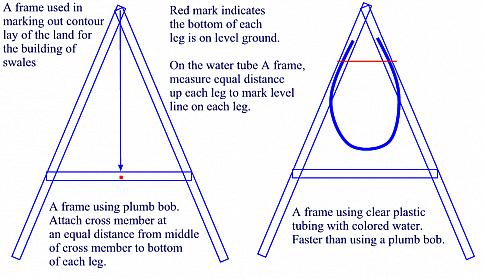

Laying out contour is easy with an A-Frame ..
Usage:
1) place aframe down .. move one leg around until you find both legs are on
equal evaluation ground, the legs are level.
2) place a stake at one leg
3) like a compass you draw circles with, swivel one leg around until you
find a level spot. Stake that leg, repeat.

Usage:
