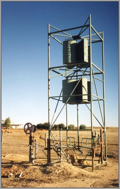

              All home improvement stores and most retail stores, even dollar stores have LED bulbs. 6.5 to 15 watt LED compare favorably to 40 to 100 watt incandescent bulbs. Even LED floodlight bulbs are readily available. Most automotive stores carry 12volt LED, which can save even more using a transformer. Flashlights and lanterns only use 4.5 volts and can output lots of light. individual LED's can be purchased at your local electronic supply store and easily make you own. A wind turbine can charge a battery and power many LED's, and more. Wins turbines can be purchase or easily built to supply power to charge batteries. I have several designs and will post one or two for your consideration. Good Luck. stealth
                A framework of pipe and several barrels or buckets cut in half lengthwise and provide all the power you need. Many sizes are available as are low RPM 12 volt DC motors*turn backwards). Belts and pulleys or chains and gears can provide needed RPM for you low RPM motor. Automotive bearings can run maintenance free for many years. Anyway the wind blows can turn this turbine. You could use an automotive type voltage regulator to prevent overcharging, and charge many batteries if needed to run you entire house or several smaller turbines for barns, workshops or other outbuildings. Good luck. stealth
