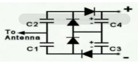

    here is some info i found somewhere online, the guy was experimenting with energy from an antena. don't know where you would put an earth, but i'm sure you can guess or experiment.

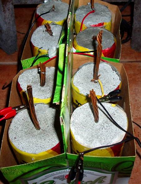

      I have mentioned that when using my older cement beach-sand cells as well as some other cells, that I'm able to light an led about 1/4 brightness on just one wire. This usually happens late at night mostly, so it does not have anything to do with sunlight, but the effect can also happen anytime. Since the led's light is unusably dim, I have not pursued it further, although maybe I should. If I touch the second pole (negative) of the led to ground, (through my body and bare feet on my ceramic tile floor), the light gets twice as bright. I don't think that this has anything to do with galvanics, and may be the real cause of why the cells work.
      As I've mentioned before many times, the two different metals in the cells work as antennas, and may also be what is giving the cells their non galvanic, unconventional output. As that energy is not contained in the cells.
      In the picture below I show the cement cells in series, that cause the effect to happen, but, I've also seen it when working with other cells as well.
      I notice it mostly when I disconnect the negative side of the led, and the light still stays on.
      I'll take a picture of the led lighting on just one wire when it happens next time.
      Nick
        Thanks for your input lads.
        I'll definitely give that circuit with the diodes and cap a try. Please leave the picture Nick - it sounds like the same thing as is going on here

                        @stringguy
                        I tried the circuit but couldnt get anything im afraid
                        • #13
                          Originally posted by seth View Post
                          @stringguy
                          no probs, just a suggestion. ive seen a few people trying that sort of circuit, but havn't tried it myself. thanks for trying.
