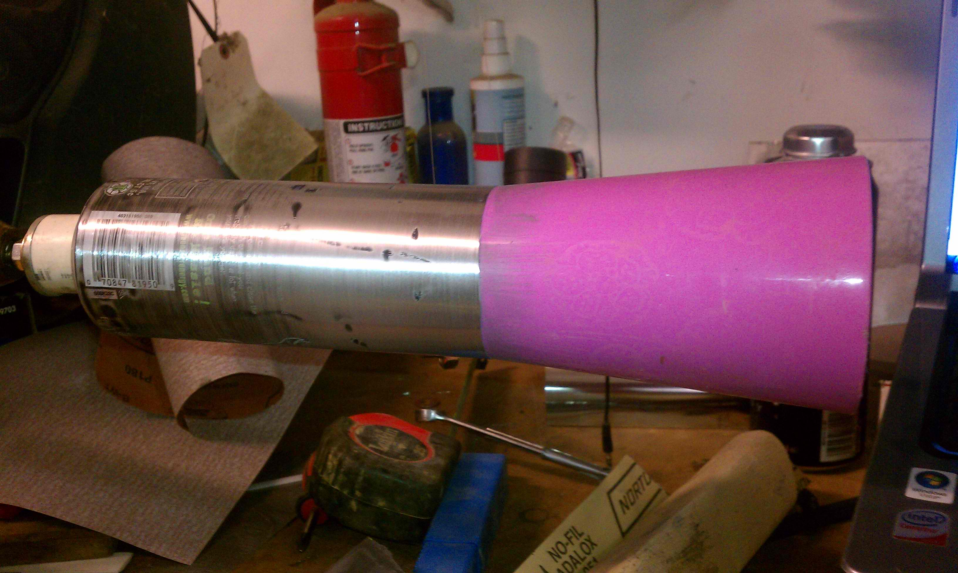

Question to the professor
This Can I am Sanding [while I run my heat tests ] ,has some imperfections
[in photo] is it possible to find a can without such imperfections?
I have been told it could take 20 hrs of sanding and tuning to get this right
I don't want to waste time on a bad can [unless this is typical]
Another question?
I have made a microscopic hole while sanding [when it was full ]
have I ruined it?
Thank you
Chet

easy sanding
Guys and Gals
I just figured out an easier way to sand cans with the top cut off.....
First stuff a rag in the can, kinda center it. it needs to almost fill the can up...then find you a plastic drinking cup thats tapered and will slide into the open end of can. press it in and Bingo!! Ive been sanding on my latest can with it on the drill,, this is sooooo much better!
And also, Thank you Professer Savic' for everything you have shared. We are very greatful, and this has been a really fun thing to do. Thanks A Lot!!
