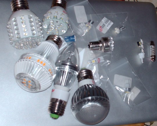

It isn't just pulsed DC. It is AC but not a sine wave. The frequency is way up there in the kilohertz ---at least with the bulbs I tested. The circuit inside the bulb is a major player in the main circuit. Different bulbs do different things. Some don't work at all.
