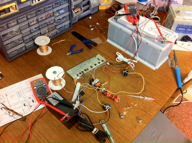

Thanks... It's all learning... for me... very fun! You'll have to excuse my ignorance, I'm not sure what I've built today, so I'm calling it the Kybrator. I'm sure it's basic text book stuff! You tell me! I was studying up, preparing to build a flip flop inverter like Lidmotors / Incroyables. This ain't that (or is it?!), but: it's fairly low draw, and met my goals for the evening.. so it was a success for me, anyway! One more step...
12VDC -120VAC Mini Inverter Circuit for AC LED lamps 12.3V / 175mA (2.15 watts)
* I switched to a TIP42C, higher output -- but it seems to be a bit of a noisy circuit. Perhaps TIP31C would work well with this.Last edited by kcarring; 12-15-2011, 06:06 PM.----------------------------------------------------

Had some good success today, been studying The Incroyables Flip Flop Inverter, Lidmotor's replication, Magnetman's work + I was building a George Wiseman HHO unit, and so I took the small PWM I had built, hooked that to the FLIP FLOP instead of using voltage regulation or a rheostat and it appears to be working out very nice! 12.6V X .385 mA (4.85 watts) drives (3) 2 watt AC LEDs very bright (in parallel) with easy dimming, no heat issues.
Given that I simply joined the two circuits, it needs some simplification, and I found all the parts in the garbage, so there are some input/output mismatches on the FETs, but nonetheless it works well, and it's a start to a good "dimmable inverter" that uses PWM to effectively change the RMS voltage, without "low voltage" dropout.
I made a few changes to the PWM and it works even better, then, I played around with finding sweetspots, different frequencies matched to different pulse widths and got the current very low for an inverter, possibly around 20 mA! Fun stuff, build one of these, but build it better... we need to get the pulse width modifiable within the flip flop, and keep the frequency @ whatever! Despite the (measured - who knows how accurate that is, all I know is the lowest I've seen before was 40 volts at this brilliance - given all the variables it is really only a benchmark against previous readings) AC voltage on the lamp of only 23 volts AC, it stays lit reasonably bright like about a 7 watt incandescent night light.
