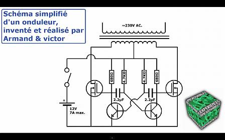

            • French version
              Just adding some info.
              Hi guys, here is a kind of simular french version, including a tutorial.
              Incroyables Expériences [73] Fabriquer un onduleur / Make an inverter (nouvelle) - YouTube

                  • After studying the circuit diagram for a little while.
                    Isn't the inverter producing 230 volt ac but at a much higher frequency.
                    All the electrical equipment works because the voltage is 230 volts a/c.
                    It doesn't matter that the frequency is much higher thats why it doesn't drain the battery easily.
                    Am I correct or not?
                    Please can you tell us what the frequency and current draw of this circuit is on load and no load?
                    • Flip flop circuit on steroids
                      I like this circuit. It is a simple flip flop oscillator triggering mosfets that turn the power on and off to the primary. Guys we can have some fun with this one. With the correct choice of components we could probably get this to do some amazing things. This is another one of those really old circuits that can be looked at again with fresh eyes.

                      • It looks like, by the components he's using it would be running at around 96hz. Not sure how that would effect 50/60hz appliances over time - some don't respond well, others don't care.
                        Similar to the Royer circuit that's used in the small inverters, also being used for driving flybacks, flouresent tube drivers and small tesla coils. It is a slick little circuit with many possibilities - a dual joule thief circuit in it's basic arrangement.

                              Here is circuit diagram from Youtube video.
                              P.S> It looks like traditional bipolar oscillator to me..
