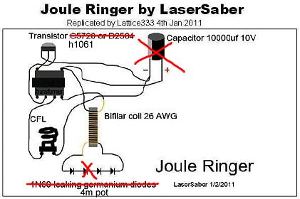

        I am almost ready to post the DIY videos on how to build a joule ringer including the transformer.
        I have also discovered that the Joule Ringer will run a lit CFL for a couple seconds after the power is disconnected, even with no electrolytic capacitor in the circuit. It just runs on the coils alone for a few seconds. I will also show this effect in my next videos. Here is the circuit that I use when running with no capacitor.

                • self wound joule ringer
                  I built a self wound joule ringer on a 2"x2" E-core. I used 24 gauge primary ~6 turns and 36 gauge secondary ~1200 turns (plus the additional turns on the secondary). The transformer worked well, but drew 10x the amperage compared to the fuji transformers. I didn't mind, since I wanted to do some experiments with a more robust transformer, but the increased current caused the whole thing to heat up pretty quick and burn up when I was using 24 volts as the input.
                  Anyone have any thoughts on how to make a larger, more efficient joule ringer transformer? The first coil took a lot of work to assemble, so if I do it again, I want to be fairly certain that I'm making improvements. I've thought about using thinner wire on the secondary, but I don't know enough about transformer theory to be sure that would help. Any insight would be appreciated!
                  • funny. I had the same thing happen to me. Toasty. I've had some thoughts. Next time i am going to cut a 3/8" ferrite rod, to about 5". I'm going to cut plastic disks, such that they have a 3/8" hole in them, and my primary is going to be double wound 26 gauge wound twisted together, not bifilar, just multistrand - about 40 turns. Then I am going to do about 600 turns on the HV - but I'm going to do my step up in stages with plastic disks in between. 26 gauge, or maybe 30 - but I'm losing confidence in 30. When I'm done I'm going to make a surrounding "coral"of home made magnetite. So it will be a ferrite central rod, with a surrounding magnetite core that has no winds on it. I got the idea, roughly - from a HV circuit in a scanner.

                      • update of circuit performance
                        I got the circuit to light partially a 20W CFL. Using a TIP3055, and winding the coils by myself. 9VDC 100mA input. Output 450V AC p-p. Sorry, I messed up the camera, so no photos at this moment. Need to borrow another camera later. I will try to replicate Slayer's latest circuit.

                        • A new transformer...
                          I ordered a couple transformers from amazing1.com (28k089) and hooked them up joule ringer style. They work great in the circuit below. I got the potted version and they seem to be able to produce the best high voltages when you crank up the power by decreasing resistance across the caps:
                          I hooked the output up to a five stage voltage multiplier and got some massive 1.5 to 2 inch sparks! Fun stuff.
                          Uploaded with ImageShack.us
                          I used a radio shack 3055, 12 volt supply. The resistor varied down to 8k ohms and the cap was .2 uF.
