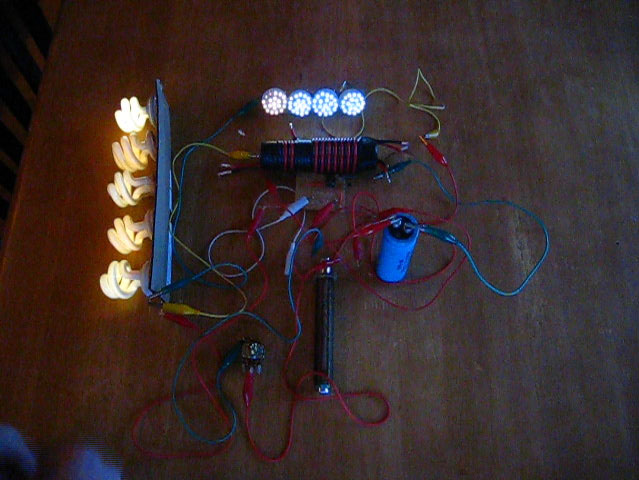

    • We have had much luck w/ a trifiler wind, feeding the 3rd winding back into the battery Bedini/Cole style. our amp meter shows we are using 340 mA but the voltage does not go down more than if we were using 1-2 mA. we are using one of our windowmotor windings, wound to run a windowmotor - turn a shaft. the light is fairly bright 15w type. then we use a choke to delay current, increase spike. this has a strobe effect w/ greater light intensity and less voltage drop. fun stuff.
      • Lasersaber,
        youre last video is very interesting from the following standpoint....
        a 32,000uF cap charged to 20V contains 6.4 Joules
        leaving the 5 CFL's out for the moment, you have 80 LED's...assuming they are fully bright ( i know they werent, but bare with me for ease of calculations ).. gives us
        2V & 0.015 A per LED (reasonable figures for an LED i think ) = 2.4 Watts
        or to phrase another way, having them fully lit for 1 second would burn 2.4 Joules from the cap, or 37% of whats in the cap for just 1 seconds worth of light.
        The fact that you got them to light for 5 minutes or so is impressive.

                  • Originally posted by rave154 View Post
                    Lasersaber,
                    However, they werent fully bright, also, LED's can fool the eye making you think they are lit continuously where-as in fact they are flickering faster than the eye can register it.....also, baring in mind that the JT circuit is an oscillator by nature.
                    a suggestion if i may?
                    instead of LED's and CFL's as a load, could you simply take your output wires through to a FWBR, then onto another cap with a resistor of reasonably high wattage rating (so it doesnt heat up) across the cap...and measure the voltage across the resistor....this will give a definitive measure of your output.....and since you know your input ( Joules = 1/2 * C * V^2 )......it would enable a clearer picture of whats happening to be formed.
                    Good Stuff, thanks.
                    David. D
                    Glad you did this i just worked out the same thing and came out very similar results on another site. I didn't see you post till now.
                    Don't know but a normal JT can not do this. Usually even a single LED will die
                    in a few seconds. So we have to make some wild guess here.
                    First the cap is 32,000uf rated 20 volts. He used 3 pp3 batteries to recharge it
                    but in the last video he said they were all virtually flat. lets suppose they
                    can reach the cap rating of 20 volts = 6.4 joules.
                    This is the same as 6.4 watts for one second.
                    However there are lots of lights and LEDS here albeit not that bright. For ease
                    of guessing lets suppose each CFL consumes 1 watt each and so does the LED
                    clusters. Chances are its higher than this but anyhow 5 cfl = 5 watts and 2 led
                    cluster 2 watts total consumption 7 watts.
                    You can see at a glance this circuit should not be able to run for more than
                    about ONE second and use all the 6.4 joules. AND this assumes ALL of the cap can
                    be drained to zero volts. In practice the circuit will die around 2 volts. A JT
                    is actually only about 70% efficient under lab conditions of measuring real
                    power IN versus load out.
                    Again i will round off to best guess and presume only 5 joules actually gets
                    converted to the load allowing for losses and circuit shut down. He says it last
                    5 mins so 5 * 60 = 300 * 7 watt load = 2,100 joules.
                    So where does it get the other 2093 joules from?
                    • BOLT,
                      i agree with your calculations and somewhat with your deductions..but still think that my suggestion will help clear things a little
                      p.s as well as a resistor acorss the output cap...you may want to include at least 1 LED or Diode in case the diode properties of the LED's plays an important part......this will mess up the power calculation a bit....but should still be an interesting & simple test to perform.
