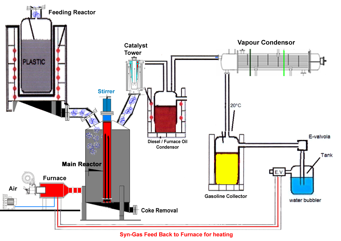

            • My 1000-liter Baby
              Originally posted by Betopty View Post
              I fully agree Tony, the material must be fed continuously for the process to be interesting. Also bags tend to burn very easily when heated..
              Hello ;
              Iam attaching a file for a 1000-liter capacity, designed for my client .
              Who want's me to make a pyro unit & than come to USA to commission it with technology transfer .
              The flow diagram is self explanatory.
              I hope tony,betopty & dutchdivco will get many answers regarding continuously feeding system .
              I designed it so that waste PE,PS & also PP-bags of sugar,floor,rice, cement.Which are dumped by many food-processing companies can be fed-In directly without even washing it .
              I would like the forum community to comment about it . Specially Jetijs .
              Anyone can also e-mail at
              ahl_asadfarooqui@yahoo.com

                  • Looks good Asad
                    Would you elaborate about how the pre melted plastic is delivered to the main reactor? Is there a feeding mechanism or is it supposed to be free flowing?
                    Thank you!

                    • Originally posted by Asad Farooqui View Post
                      I would like the forum community to comment about it . Anyone can also e-mail at
                      Hi Asad your design looks excelent.
                      I`ll make a couple suggestions not from the pyrolisis point of view were I know nothing, but from the plastics production point of view.
                      1.Unless you use some sort of auger feeder system, pressure differential system, I`d doubt you would be able to get the plastic to flow, specially if you are using fracytional melt index plastics such as bags, or blowmolded articles. Fracyional melt indexes (for those of you who do not work with plastics are plastics that are designed not to drip so that they can either be turned into bags or moulded bottles and such) This antidripping property so valuable when procesing would work against the design.
                      Alternatives might be the addition of waste oil might which might allow your plastic to flow by lowering the general melt index of the mixture. Perhaps placing some water in your mix would give you steam that would increase the pressure in your vessel allowing the displacement of the mix, if you calculated your water right you might end up with a mostly empty chamber and little no no water in your mix. The feeding reactor would of course need to be airtight which I see no problem in achieving. Compressed syngass or nitrogen might be pumped into the plastic reactor as well to enforce the displacement of the plastic, it just might be slightly costlier.
                      2. My boilers have flue temperatures in excess of 250oc even after 3 passes through 12 meters of water surrounded pipes. Assuming your main reactors burner`heat transfer is as efficient as a boiler (which it might not be) your flue gases will be at least as hot as mine. I believe that these gases directed into the space between a double layered plastics reactor, would allow for working temperatures of over 125oC to where our plastic would become liquid and allow itself to be pooped and farted (could not think of any other expression; sorry for the image) into the main reactor. This would allow you to skip the heating elements in the initial plastic reactor. In fact it might even (optimistically speaking) allow to skip some of the heating elements in the diesel/kerosene/oil condenser. or at least in your catalyst vessel (asuuming it is heated)
                      3I'd Take the air expelled from the radiator cooling your condensor tubes and focus it on the material waiting to be placed in the plastics rector thereby your plastics, when entering your plastics reactor would already be hot and dry.
                      Questions
                      1.Are you using 400oc+ Ball valves, or slide gates? I`d like to know more about these.
                      2.Your burner seems interesting as well. Do you worry about your vessel getting hotter on one side than the other? or will the stirrer solve this.
                      3. How do you know when your vessel is empty so that you empty your char/as deposit? How do you know the level of your soup inside the Main reactor so that you dont add your plastics to soon(overflow) or too late (inefficient)?
                      I`m hoping you do not see me as critizicing your design, in fact it is quite the opposite it is an almost ideal design, one that with your permission I`d ideally like to mimic at some point.
                      • feeding system
                        Originally posted by Jetijs View Post
                        Looks good Asad
                        Thank you!
                        Jetijs
                        Hello ;
                        Thanks for your comment .
                        Yes there is a feeding mechanism . Initially its a forgesteel valve operated manually .
                        Afterwords it is possible to automize the system by placing 02-censors, in the main reactor . As soon as the level of the feedstock drops to 25% level, the censor will open the valve & as soon as the level of the reactor is 75% filled, the second censor will shut-off the valve .
                        • heating system
                          1.Unless you use some sort of auger feeder system, pressure differential system, I`d doubt you would be able to get the plastic to flow.
                          Questions
                          Hello ;
                          It's nice to hear different concepts the forum community puts up .
                          1) You can notice I have One Furnace only.
                          The flu-gas coming out of the main reactor will definitely be utilized to heat-up other vessels .
                          2) Flowability of waste plastic into main reactor. I don't forsee any problem .
                          3) Only High temperature forgesteel gate valves are used . Hand-valves have teflon seal with the ball which will melt soon .
                          Ordinary gate-valves have glanddori resistant upto 150celcius which is not enough .
                          4) Stirrer definitly helps in homogeneous heating + mixing catalyst & most importantly Char removal .
                          5) Level indicators . I just explained to Jetijs .
                          • more questions...
                            Hello ;
                            Understanding this is your invention, you probably spent much time designing it, and you are in bussiness doing it, please feel to just respond to the questions that are not "classified" or "secret" to your design.
                            1.How are you solving the problem of flowability? I seem to remember you have a background with plastics or paints.Simply allowing the plastic to flow would either not happen or take quite a while, so I`m assuming you have something I overlooked.
                            2.When your client decides to upgrade to automatic he can use electric or hydra-pneumatic operated. Schubert &Salzer has some good sistems for 450 degrees, and their (2" steam are the ones I use) valves last a lifetime, although they are not cheap. Vatac is another option as well as KOLINK that are cheaper, but i do not know how long they last. There is an italian company i will try to find the name that uses the same valve body for automatic and manual. Therefore when you upgrade only the top portion must be replaced, saving 50% of the cost, and all the instalation cost, as existing valve is not removed
                            3. Can you more detailed specify What sort of level indicators you will be using? I looked up O2 sensors and I can`t quite see how they would work in an O2 deprived reaction vessel. My boiler has warrick sensors but I doubt they would work/survive the atmosphere inside the main reactor. Banner has some inductive (or condustive or someductive )sensors that are rated to 450oC but I doubt they would work as they require an electric current to be passed /or convected or bounced or something and I do not know if plastic would be able to do this. Perhaps flow sensors that would detect a swirling mass... Any hints?
