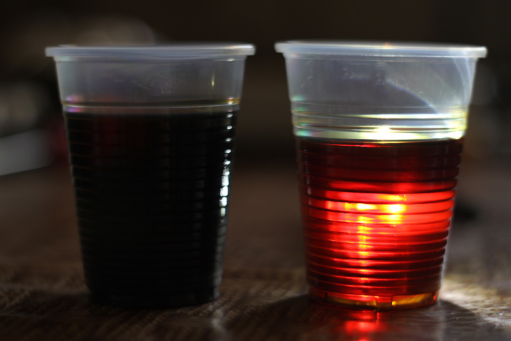

                  • Ok, more photos of the fuel.
                    On the left is untreated one after two weeks. It got completely dark red, non transparent with some sludge on the bottom.
                    On the right is one treated with stabilizer. It remained transparent and no sludge. In reality the colour is dark yellow.
                    • Great
                      What stabilizer are you using?
                      • It is liqui moly `speed diesel`. I was assured from their sales rep this additive should solve my problem. So I`m testing it now.
                        BTW, jetijs, I remember making the fuel some time ago using only PE but I still had problem with sludge and darkening, apart from the waxes. Are you using anything else in your reactor mixed with PE?
                        • Thanks for the info
                          I am experimenting with PE only at the moment, there is nothing else in the reactor. If the waxes are put through the process again, I get reasonably clear fluid with low wax content that can be filtered out. After that the fuel stays yellow/orange/brownish and does not dargen over time. I have a sample my friend made a year ago - it is still the same color and brightness
                          The only liquid sample from PE that turned dark after a short while was the fuel drained from the system at the very end of the process and at temperatures higher than 440 degree celsius At first it was dark red like cola and totaly transparent, but the next day you could not see through even when looking at the sun through it.
