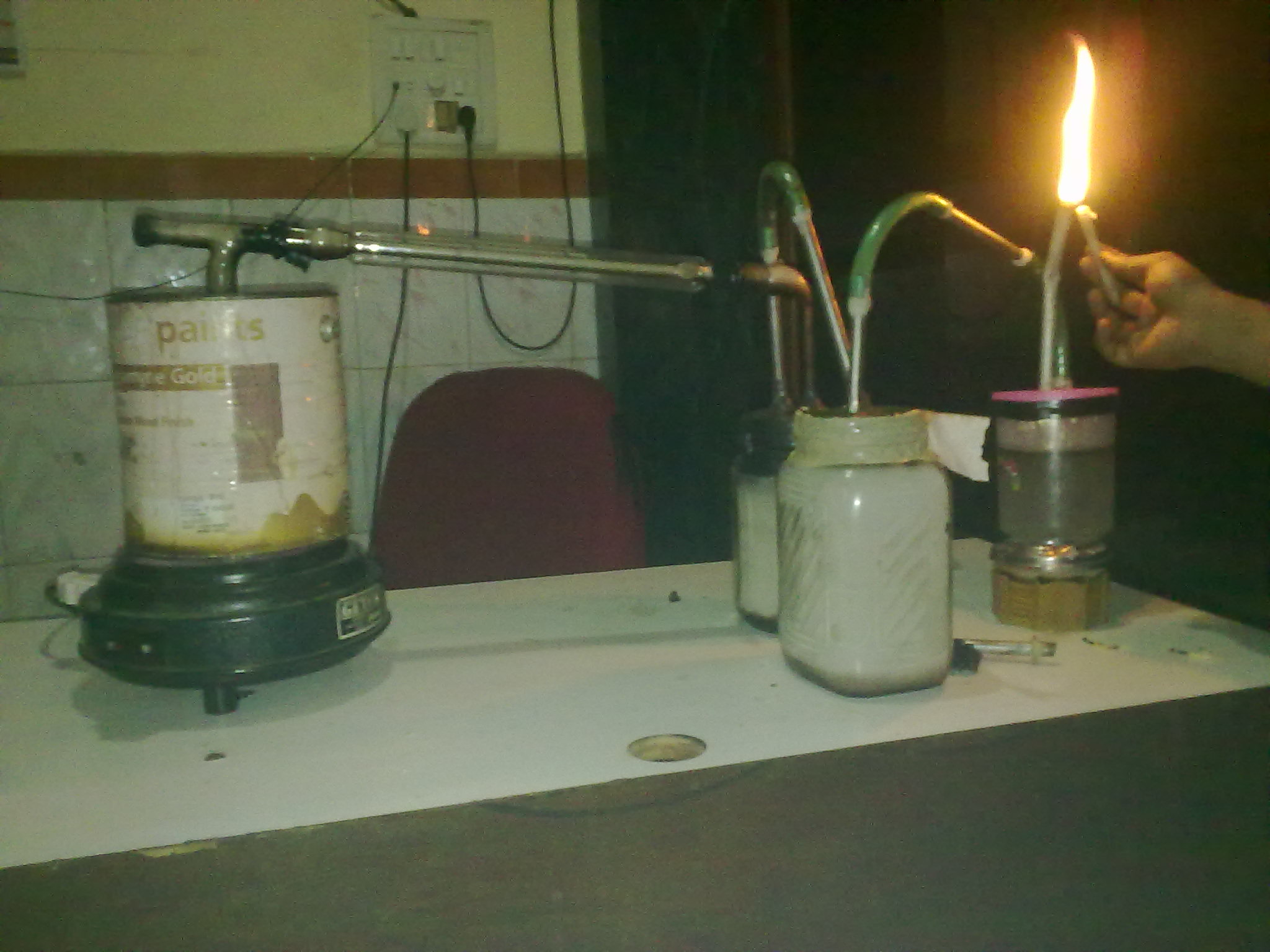

            • My Reflux tower .
              Originally posted by imakebiodiesel View Post
              A question Adad, how near to the top can you fill a reactor?
              Is there a danger that the wmo/pp mix will foam up and travel up the outlet if it is over filled?
              Does it have internal baffles, or any material to slow down the flow of vapour. I have constructed several reflux towers for methanol recovery and found that filling the tower with rashid rings, glass marbles or even stainless steel scouring pads increases the efficiency by a lot.
              Good luck with your new processor.
              Hello Imakbiodiesel ;
              1) Reflux Tower :
              My reflux tower has NO baffles OR anything inside because I don't know about baffles ...........
              The reason I thought it should have nothing-INSIDE, is that what I expect from this reflux reactor is to throw-Back/down all the heavy fractions above 350 Celsius back in the main reactor. As Jetijs once said, "these fractions Could be chopped again & again until they are in diesel range ".
              The heavies I expect to be quite thick may need more CLEAR space .
              The bottom of the reflux reactor is deliberately conical & a 3" inch pipe is joining it with the reactor . Otherwise all the other pipes I used are 2"-Seamless pipes .
              2) WMO/PP foaming issue :
              I haven't experience any foaming issue when using this hybrid products .
              Carbogger & even Jetijs (I guess) fully load the reactor upto the lid .
              I prefer to fill it 2/3 of the total loading capacity .Infact my first batch was just 1/4 of the capacity . Next batch tomorrow Inshallah I will be filling 1/2 & gradually I will increase the quanitity .
              Here we should seek GrandPa-Jetijs advise............(according to duchdivco)
              The reason for gradual filling is that if any flaw comes up it will be easier to shut down the system immediately rather than full load.
              Another reason of putting reflux tower on top of main tower is that by any chance foaming occurs, the reflux tower I hope will drop it back
              to the main reactor as the height for the foam/vapours are increased about 04-feet more ???
              Iam afraid I make too long explanations , should I ???

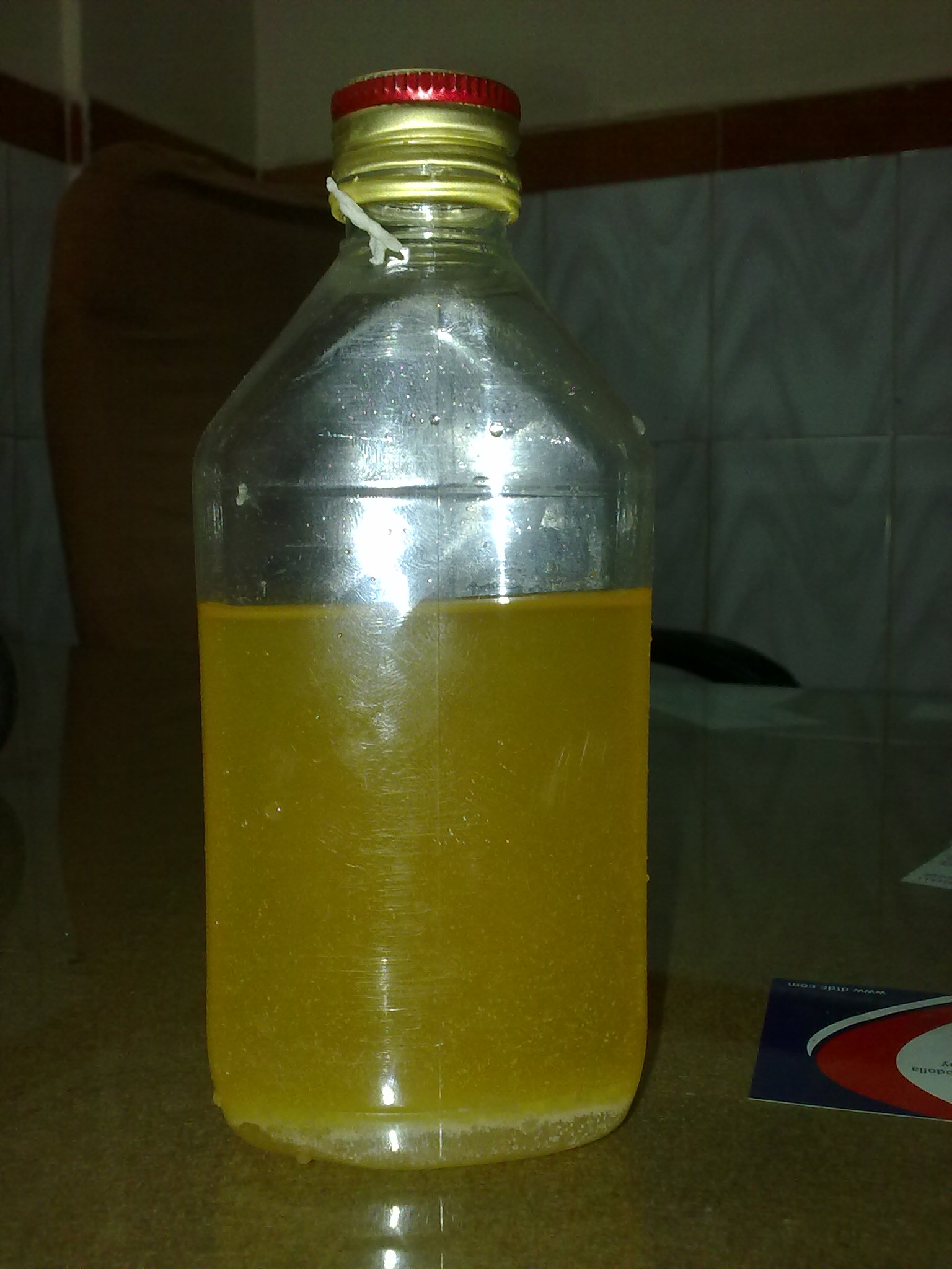

                            Today I testes the Gasoline & Diesel fraction I collected from the first batch of my 100-G Baby .
                            Gasoline fuel performance is excellent .
                            Diesel range fuel is not upto the mark , color Blackish & performance below average . seems to be viscous,
                            Tomorrow I will check its viscosity & S.gravity & report back .I also plan to re-heat the diesel fraction upto 350 Celsius .
