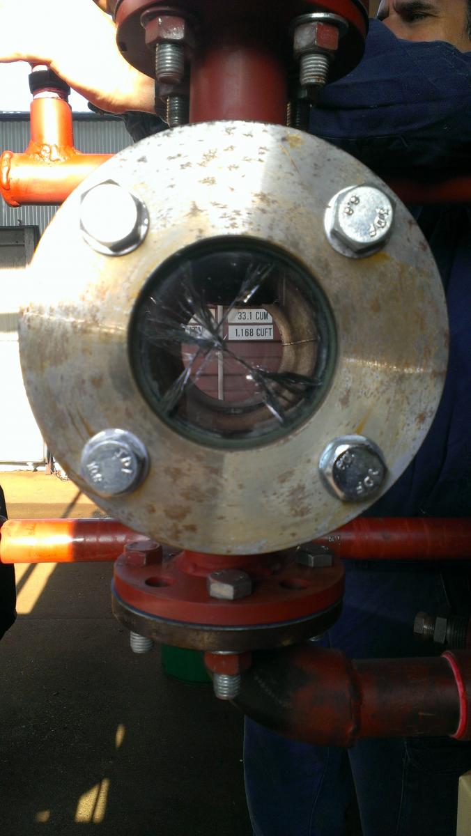

I bought some borosilicate sight discs (111mm diameter x 15mm thick) and sandwiched them between standard 3" flanges using NAF (non-asbestos fibre) gaskets. Carefully torqued it up and thought it was job done. The next day one of the discs shattered. I replaced it, this time not as tight. I left the project for a couple of months and came back to it yesterday. Left it in the sun for a couple of days and the other sight disc shattered. Lucky I bought 4 sight discs!
There is not much compression or give in a NAF gasket. I suppose I had the bolts done so tight it was just below the shattering point of the glass, then on a hot day the sun heated up the flanges and the extra expansion added too much pressure on the glass.

Spoke with the manufacturer of the sight discs. He insists the discs are made of Schott Borofloat 33 which he says is a German product within the Borosilicate family. He says the English call it Pyrex. There are a number of names for it but it is definitely borosilicate. He was very surprised they were breaking, suggested a couple of things to look at such as flatness/smoothness of flanges, method of tightening, machine a step into flanges for placement of discs, agreed the O-rings would be a good and more acceptable method than the low-compression NAF gaskets.
Here are a couple of photos.
I'll go get a step and O-ring groove machined into the flanges and see how I go after that.

The way it's broken suggests it's not toughened glass.
For Viton or silicone rubber o-rings I suggest a crush of the rubber to about 70% of the original thickness, so if a seal was 3.5mm, crush to say 2.5mm. I have o-rings on both sides of the glass. One chipped once because the steel housing came into contact with glass edge. As an afterthought I fit a rubber band around the glass perimeter to isolate it from direct steel contact on the periphery. I made it from old motorcycle inner tube though it needs replacing once in a while.

The breakage has been caused by stress due to the plates being too tight and the seals having not enough thickness to allow for the movement. Fibre seals like you are using are not right for this situation.Originally posted by Col View PostThanks guys

Yes, I agree, the bolts and flanges are massive compared to the brittleness of Pyrex. The suggestion of an o-ring on both sides of the glass is good, verses a thin fiber seal.
You would want to have about .5cm of thickness of the seal on both sides to afford some flexibility.
Also, you will not need more than a slight compression of the o-ring. The problem was most probably differential thermal expansion in the sun. So, a thick seal will allow some flexibility in the seal if it is not fully compressed.I have been running various blends of waste oils and unleaded gasoline in a 1983 Chevy G-20 van with a 6.2L diesel V-8 engine, with a Stanadyne Rotary DB2 IP since Feb, 2007. I have started the engine with no difficulty and no block heater on an 80/20 (WVO/gas) blend down to 0F (-18c). I have found that by blending as little as 15% gasoline in the summer, and as much as 50% in the winter, my engine starts and runs as if it was running on diesel fuel.

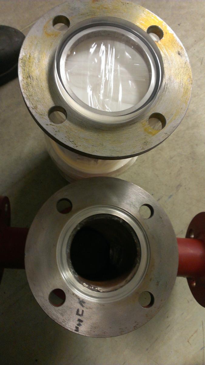

machined flanges for sight discs
Yes, the bolts are overkill, but that is what suits the flanges available off the shelf at the fittings store. I know we're not expecting any pressure in our systems but so much talk earlier of retort flanges not sealing led me to think better over kill than under done.
I've attached a picture of the flanges now machined to have a step to retain the sight glass and a recess to locate the O-ring. All four flanges have been machined so there is an O-ring on each face of the glass.
