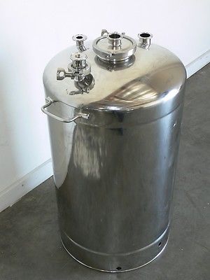

I add in my 2 cents starting with the easy part first. Electric or flame! I understand exactly where BBD is coming from, but actually, there is no difference in a Flame or an electrical element when it comes to danger of ignition. The heating element is way beyond the temperature of ignition and in fact, can be an even greater ignition source simply because there is good oxygen content around the element. Where as a flame is using up the oxygen. However, what really must be taken from BBD's comment is that this entire process is dangerous and needs careful thought to all aspects of safety.
Forget a pressure gauge. The bubbler tells you all. By the time you see a pressure rise, the pressure is already there and the fact that a blockage has already occurred and the biggest issue is stopping that pressure rise. If you turn the heat off, there is still pressure rising. It is better to have decent pipe size for good flow as Excalibur suggests.
Don't use copper. Copper acts as a catalyst, but not the right type of catalyst.
Don't use Aluminium. Ally has a melting point of 630degC. You will be getting close to that temperature and that means the vessel material will be losing strength. Should some issue develop, you don't want vessel failure. You want it all to hold together till the temperature drops enough for pressure to drop.
BUT PLEASE!!!!! don't do this inside your Motorhome, just in case you are considering that. It is far far too dangerous, right from fire to explosion to dangerous gasses.
