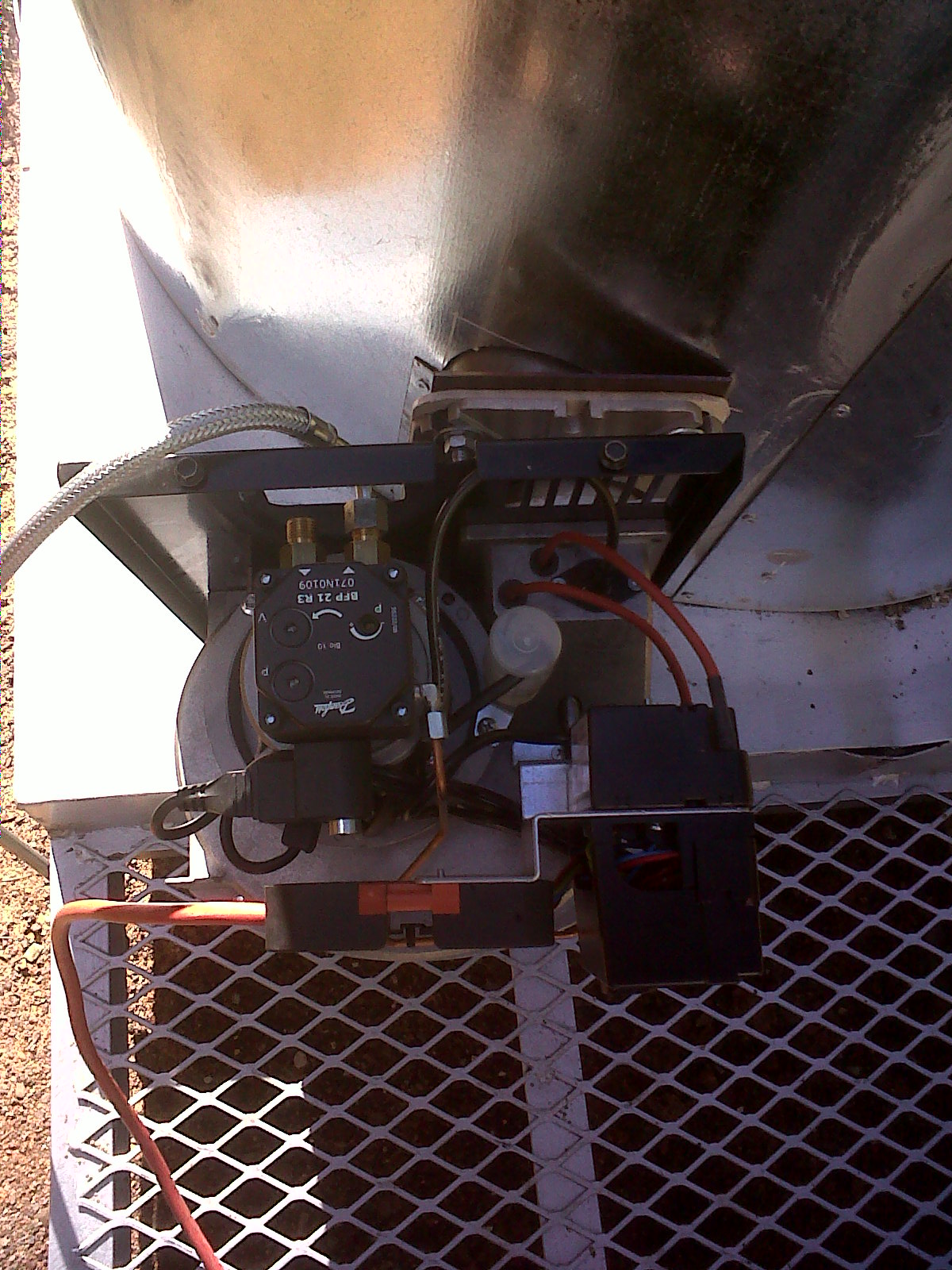

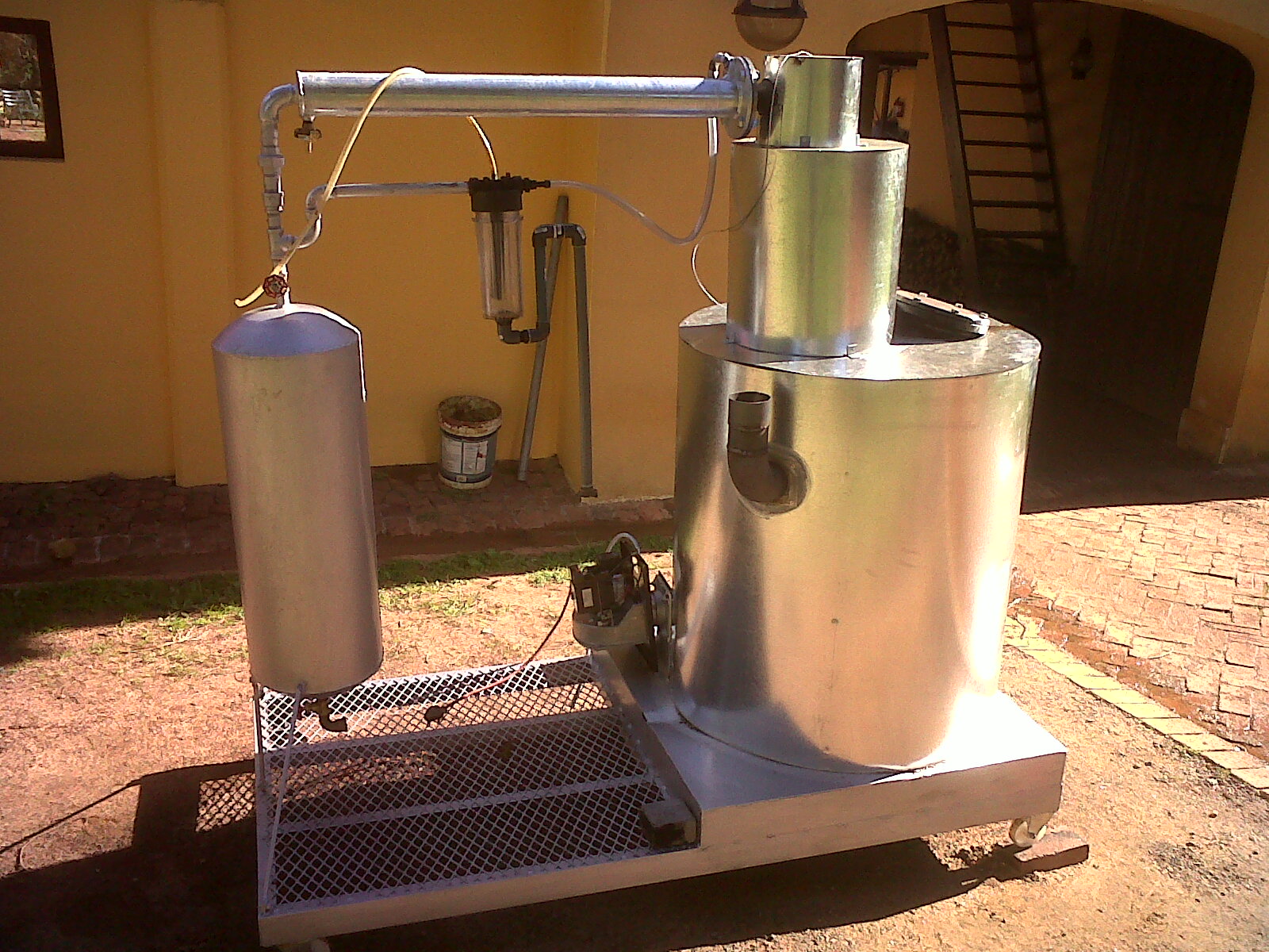

Hi folks,New problem for me, but i believe others have had this happen in past.
Brand new system built same as before but this time my heating source was a new duel fired diesel heater.Old system was on lpg gas, but bought new system to improve production time etc.The diesel heater has a capacity of producing 69Kw/hr..
When i fired up the system i reached 200*C IN 15min, all looked good, then started producing wax product that carried over to my collection tank.Stopped plant.
In the past with lpg this never happened.I think this is because i had a too fast increase in temp and caused blow through?
Only other change i made was to the distillation column, where i went from the plate system of baffel's which gave me a wet -out in certain temp range to a composite of fillings of metal internal.i.e simple distillation.
Would appreciate your feed back.
