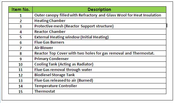

First of all I would like to thank you for sharing this great thecnical know how of making diesel from waste plastic.
I hop you have gone through my previous post to make this self sufficient unit.
I have small doubt, you said you tried withh all kinds of sealing materials but the performance was not as desired and finally you made a "V" shape grove for sealing. I want to know what is the depth of grove and any kind of sealing material is also used with grove.
Once again thanks for your efforts and help.

Also I Need your guidence to make one reactor. Please can you post the actual dimensions of your project. as what ever literature I have read till now on Pyrolysis conclude that Temperature and Residance Time are two inportant factor which decide tha Quality and Quantity of Diesel and other products that are produced.
Also I have a doubt that What will happen if there is a leakage and Air/Oxygen enters inside the the Reactor at say peak period i.e. at about 400 deg. will it turn into explosion (Fire) as flamable gases will get oxygen or just that batch will be failed and plastic will turn into solid lump.
Thanks in advance for your quick reply.
