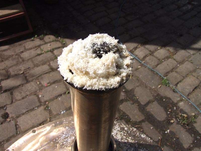

              did a run the other day with mixed ground plastic... 5 kg went in...
              about 200ml of liquid fuel and 1 litre of water came out... lots of gas???
              when the liquid stopped dripping we turned it off...
              when it cooled we opened the reactor and noticed white shiny crystals???
              opened the reflux and it was packed solid with white crystals???
              opened the first condenser and yes... more white crystals...
              they burn v.slowly and are v.energy dense?
              What craziness have we created this time???
              we did a test with the plastic (floating it) and it was full of unidentifiables (PET, PVC, ABS, etc....) so from now on we will be floating all our plastic...

                  • Weird White Stuff
                    The picture below shows the top of the reflux (which was at 140degrees C) when we turned it off
                    • If you are going to crack hydrocarbons then you need to keep the first reflux at the temperature of the cracking unit; otherwise you will get a plug, as you showed above. DO not try to do too much at each stage. Instead think lots of stages not few stages in refluxing and condensing.
                      I have been running various blends of waste oils and unleaded gasoline in a 1983 Chevy G-20 van with a 6.2L diesel V-8 engine, with a Stanadyne Rotary DB2 IP since Feb, 2007. I have started the engine with no difficulty and no block heater on an 80/20 (WVO/gas) blend down to 0F (-18c). I have found that by blending as little as 15% gasoline in the summer, and as much as 50% in the winter, my engine starts and runs as if it was running on diesel fuel.
                      • My guess is one of the main reasons why regulars drop off this thread is they end up with a plugged reflux, like above, it blows up their retort, and if it does not kill them, or put them in jail for causing death and/or injury to others, then they are hopefully too scared to try making another pyrolysis unit, because a plugged retort will make a big boom when it goes.

                        • How very dare you?
                          I consider that an insult....
                          I think one of the reasons people drop of this thread is they cant be bothered to do things properly... or they are busy and have moved on...
                          A picture of a plugged reflux (3" wide) on a 50litre reactor should be a warning to those using 1" pipe... Pressure gauges cost v.little and we have two blow off valves, which despite the blockage have never gone off...

                          • Pyrolysis of plastics is relatively safe if you feed hdpe, ldpe, pp only. A simple sink/float tank is all that's needed to test plastics. I've never ran into problems using every plastic that floats in water.
                            I believe your blockage is caused by something in your feedstock which you already said you knew. With the appropriate catalyst you can process many more types of plastics.
