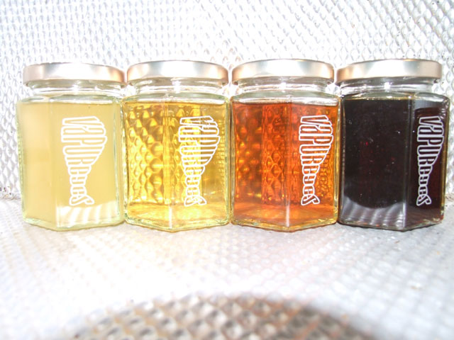

Oil Samples
We had a good start yesterday (11:30am) and we were still running a batch at 4am.... Far too much patience
I'll be warming up quicker in future...
Our time consuming method allowed us to take samples at different temperatures and we were left with at least 13 noticeably different colours of fuel
We also found that the fuel from poly prop will easily dissolve the waxy crystals from the carrier bag fuel. 100% carrier bags didnt look waxy but v.dark. When the carrier bag fuel cools to 0degrees it goes like runny jelly...
The feedstock on the last run was slightly wet poly prop pellets, strange thing is, to me at least, the water only came out after approx 330 degrees C... along with the first fuel fractions...
