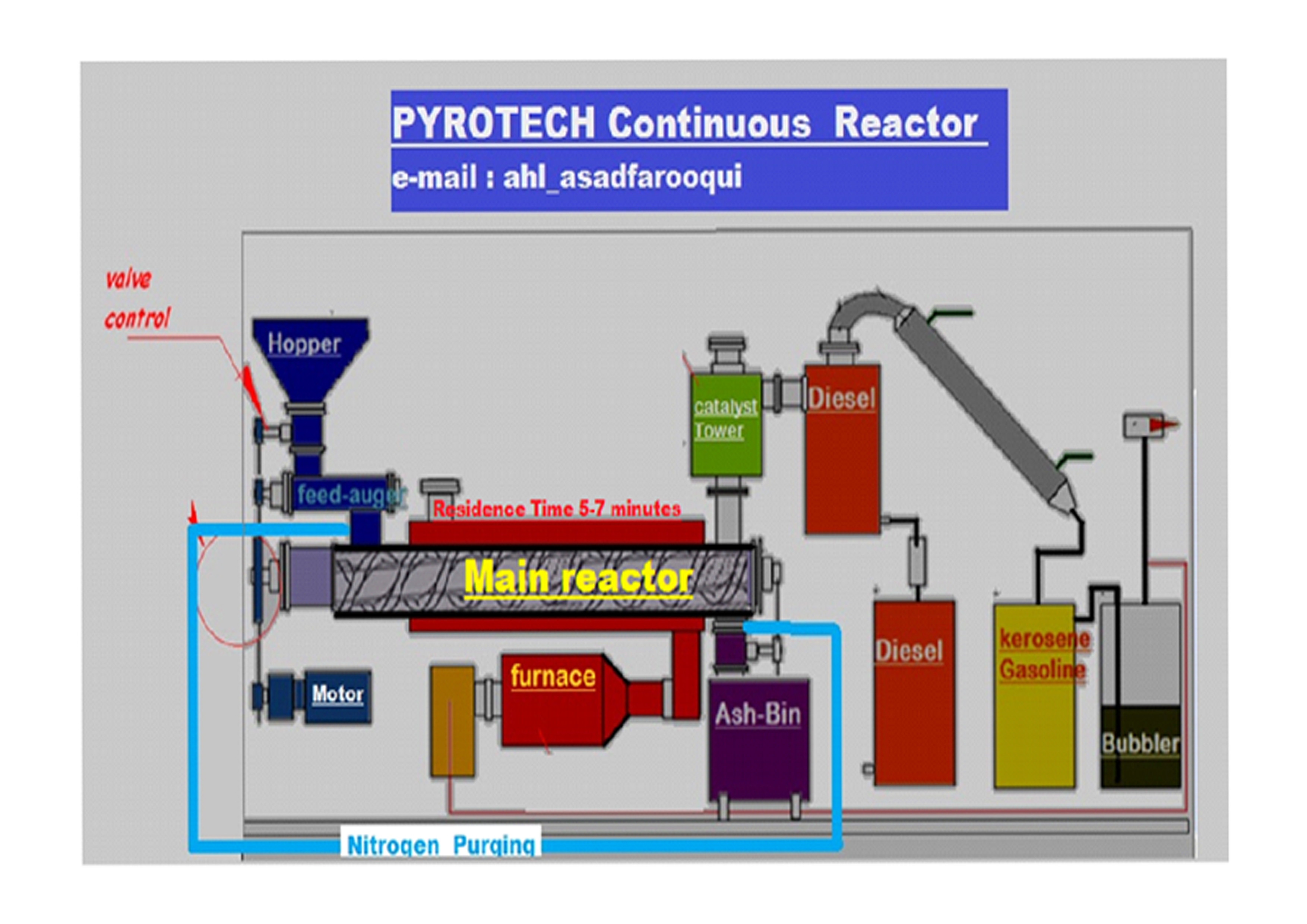

                        • My continuous Reactor
                          Iam pleased to upload my New continuous reactor Design which Iam working-on nowadays .
                          The reactor temperature is maintained b/w 450-500 ceclius .
                          reactor is made in Stainless steel so it reaches the required temperature in an hour .
                          Residence time of feedstock is 05-07 minutes only . Not hours .
                          Feedstock is continuously feeded in & instantly pyrolysed under Nitrogen blanket.
                          My goal is to make a machine which can run upto 20-hours continuously, if required .

                            • Originally posted by Asad Farooqui View Post
                              My e-mail : ahl_asadfarooqui@yahoo.com
                              Why could your design not run 24 hours continuously?
                              Do you plan on using a only vapor phase catalyst, liquid catalyst, or both?
                              • Hi ASAD, Congrats for the achievement. What is the R P M of screw fedder in continous reteort and how many kgs u load at a time.
