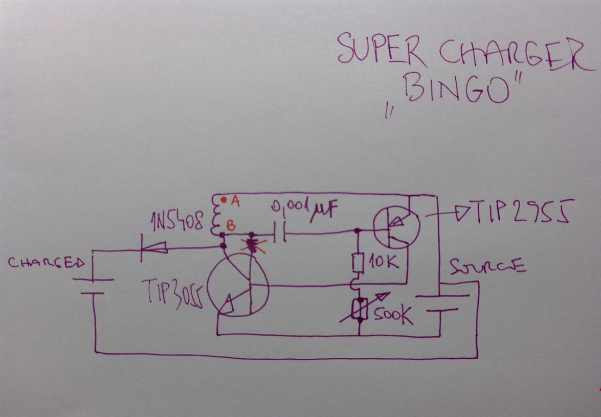

I made this stuff thanks to JT thread and what i have found there and
thanks to Sucahyos stingo making experience, i made a lot of measurements
and comparisons and i think that this stuff deserves to be named super
charger, but enough talks for now...Just make it and enjoy it !
For coil just use ordinary stingo coil, but since it is not stingo you can call it,
let say "bingo"...
Cheers !
