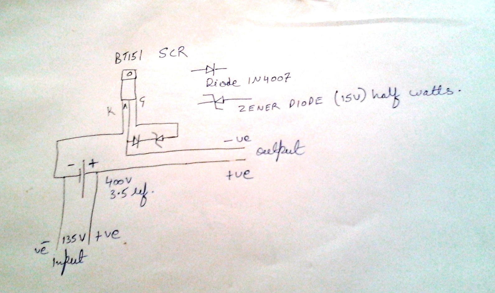

Well i've set up a 24 volt supply limited to 30 Ma and the mosfet isn't working.
So i'm going to try some things with an SCR see what happens.
I'll give it another shot tonight.
