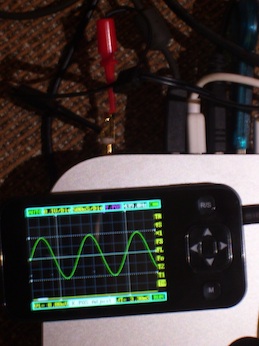

    Attached is the output of that program. Sorry it's fuzzy. The built in soundcard on my mac mini puts out 250 millivolts. Hook it up to a home stereo amplifier to get more.
    I'll have to fiddle around a little more to figure out how to do amplitude modulation. It's probably not too hard.
