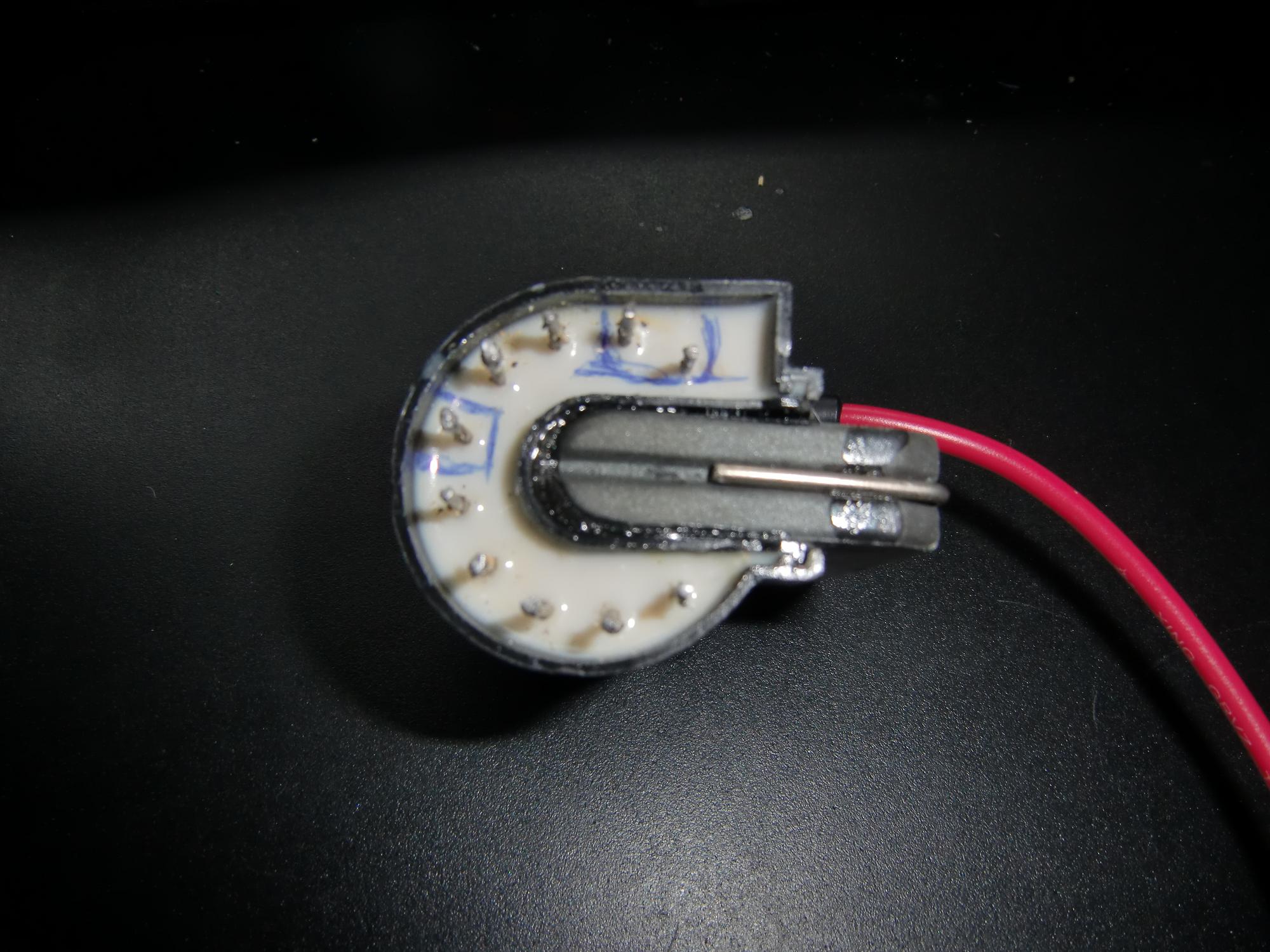

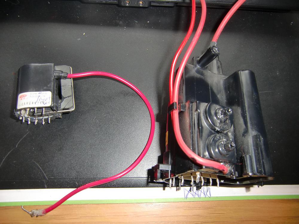

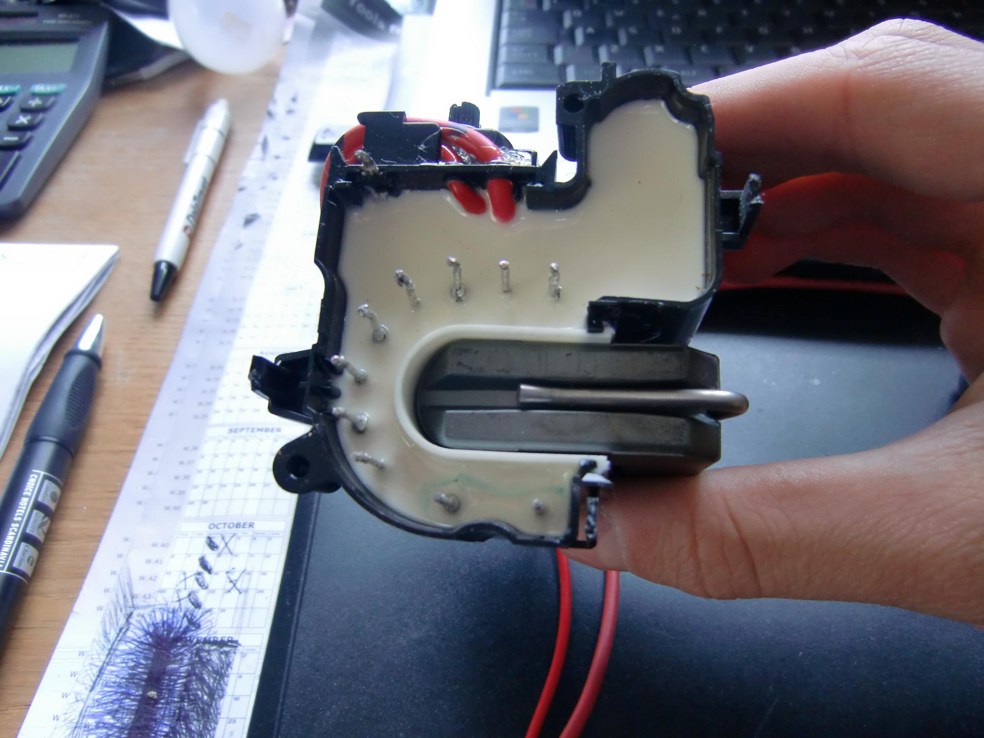

    Hello, I got two flyback transformers, one small(BSH8-II5513L) from a blackwhite tv and one big(FTX-14005) from an old computer monitor.
    The small flyback transformer has 10pins and the big one 11pins.
    (See Attachments)
    So what i want to do is make a HighVoltage PowerSupply out of each one just to learn (and possibly to have some fun). I want to start with the small one since its (if im correct) the weakest one.

    Anyhow. I think i have found the inputs and outputs of both the flyback transformers, but i am not so sure about it since none the outputs give any arcs. Does flyback transformers give arcs even though they arn't hooked up to a timer?

                That sounds as if you have "shorts" in the flyback. Did you load the flyback with something at all (spark gap etc.) ?
                Observe the bottom pins. Is there arcs visible between some of those pins?
                If so, then you would have to isolate the unused pins with PVC or any good isolation material.
                I used cable material as you can see here:
                Uploaded with ImageShack.us
                For me, flybacks where two secondary cables are on top work better with
                less shorting at the bottom pins, because the physical distance is bigger that way. Like this model here:
