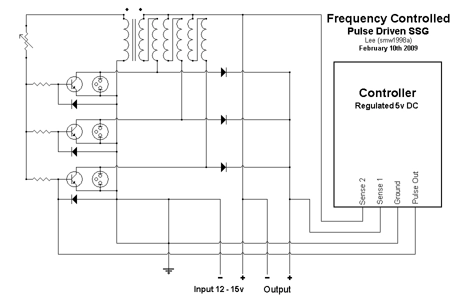

Now add a switch into this circuit, you can either add it between the 24v positive terminal and the bulb (high side switch) or you can add a switch between the negative terminals of the 12v and 24v batteries (low side switch). Now you can interrupt the flow of current in the circuit by activating the switch, opening and closing the circuit. What happens when we replace the bulb with an inductor and rapidly switch the flow of current on and off. When the switch is closed the inductor converts the current into a magnetic field around the core of the coil, this limits the current through the circuit, as the field builds less current is diverted so more current becomes available to the circuit and to the 12v battery. This is what is known as the rise time of the inductor or the coil charge. Because of the way the inductor works, current rises in the circuit as the coil charges, therefor, current also rises in the charge battery.
When the switch goes open circuit, the flow of current from the 24v battery stops instantly. Charged inductors hate this, so the inductor will no take the role of the power source by collapsing the stored magnetic field inducing a reverse the polarity potential in order to keep current flowing in the same direction as when it was abruptly switched off. If there is no closed path for the energy you get a huge voltage spike so we include a path from the negative terminal of the 12v battery to the top of the coil to allow the energy induced by the collapsing field to dissipate as current through the 12v battery. The inclusion of the blocking diode creates a closed loop during the field collapse only and blocks when the switch or transistor is conducting, charging the coil.
