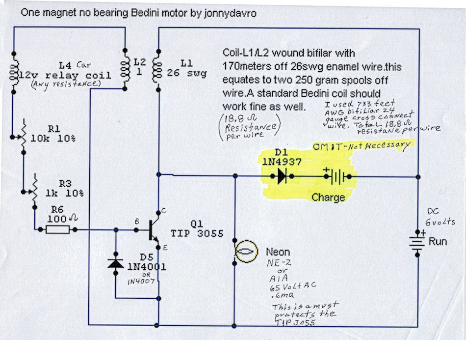

    Do you have a place where I can see the schematic, each coils construction specifications like size of wire and turns, magnet specifications?
    I'd like to duplicate what you have.
        I can E mail you a jpeg Bedini/Davro circuit diagram that has all the info you are looking for. For starters you also will need to buy a 1 inch long, 1 inch diameter Diametric ring magnet that is polarized on the rounded sides. Not the ends.
        Magnet has a .25 inch diameter hole through the center of it.
        Send E mail to 65t@comcast.net and request circuit info.
        Also need to construct a non metalic spool that your magnet will fit inside and spin. I used #30 AWG magnet wire and 3200 feet of it wound around a plastic spool. Single strand.
              Here is the Bedini/Davro circuit minus the magnet flux pickup coil and magnet.
              Tom
