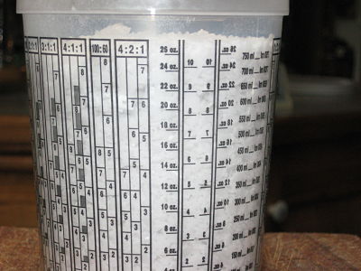

        Potassium Hydroxide Measurements
        I was finally able to get this weighing out of the potassium done today and get some pics taken so you can see.
        What I did here was to weigh out the potassium in a 1 gallon measuring disposable tub, then I transferred the contents of that gallon tub into a 1 quart measuring disposable tub so that I now use the liquid measurement system instead of the weigh it out every time system. I have used this method for years and it works fine as exact weights are not that critical.
        The quart tub of dry potassium shows over 26oz, it turns out i did not get exactly a 1 quart container as one quart is 32oz. I have used 32oz. for years as my measurement for 1.75 lbs of dry potassium hydroxide. Doing it this way I can scoop out quickly 30-32oz of potassium and get the lid back on my 5 gallon bucket to seal it up air tight as potassium hydroxide attracts moisture out of the air like a sponge. If it is left open too long you will have large chunks stuck together making it more difficult to use the dry system of measurement here.
        WARNING: WEAR EYE PROTECTION, HEAVY RUBBER GLOVES, AND A RESPIRATOR WHEN WORKING WITH POTASSIUM HYDROXIDE, HIGHLY CORROSIVE BASE, WILL EAT FLESH AND CAUSE SERIOUS BURNS CAN CAUSE BLINDNESS, BREATHING DUST WILL BURN AND DAMAGE LUNGS. PAPER STYLE DUST MASKS ARE NOT GOOD ENOUGH PROTECTION. IF YOUR SWEATING AND EXPOSED TO DUST IT MAY START TO BURN FACE OR OTHER EXPOSED SKIN AREAS, FLUSH WITH PLENTY OF COLD WATER. I ASSUME NO LIABILITY FOR ANYONE USING POTASSIUM HYDROXIDE, USE AT YOUR OWN RISK!
        WHEN MIXED WITH METHYL ALCOHOL THE REACTION CREATES METHYL HYDROXIDE TO WHICH THE FUMES ARE DEADLY, USE IN WELL VENTILATED AREAS PREFERABLY OUTDOORS TO LESSEN THE CHANGES OF BREATHING FUMES ALWAYS WEAR A RESPIRATOR WHEN STANDING OVER METHYL HYDROXIDE SOLUTION WHILE MIXING. REACTION CAUSES SOLUTION TO HEAT UP, ADDING TOO MUCH TOO FAST IN A PLASTIC CONTAINER MAY CAUSE IT TO MELT OR WEAKEN. USE COMMON SENSE WHEN WORKING WITH THIS CHEMICAL AND NEVER MIX THIS FORMULA WITHOUT PROPER PROTECTION. CONSULT YOUR LOCAL HAZ-MAT CREW TO FIND OUT WHAT PROPER PROTECTION IS NEEDED FOR THIS CHEMICAL MIXTURE.
        Consider yourselves placed on notice and warned.
        1 and 3/4 lbs or 1.75lbs (30-32 oz) is what I use in 5 gallons of Methanol (Methyl Alcohol) to mix into 25 gallon of my clean clear used veggie oil as mentioned earlier in this thread. That is of course after the oil has been preheated to aprox. 150* F.
        If you are not allowing your oil to settle out then double the amount of potassium per 5 gallon of methanol or 3.0lbs (60-640z).
        Potassium is almost double the cost of lye. I pay $1.00 per lb for potassium by the 50lb bags. I pour off about 25 lbs of the bag into a 5 gallon bucket that i have a good sealing lid for to keep airtight. Then I wrap the bag up and clamp it to keep all air out.
        Each 5 gallons of mixed Methyl Hydroxide is added to 25 gallons of hot oil. Therefor if you are making lets say 5 gallon batches of bio-diesel you simply do the math 1 gallon of Methyl Hydroxide to 5 gallons of hot oil. The dry weight of potassium is about 6oz, so use a smaller measuring cup with oz measurements on it...to be exact its 5.6oz again this is NOT WEIGHT its liquid oz measuring system by sight. if using the 5 gallon + 1 gallon of Methyl Hydroxide your going to need at minimum a 6 gallon container to mix in. This is why I like using 25 gallon + 5 gallons Methyl Hydroxide in 30 gallon drums.
        When mixing the potassium into the 5 gallons of alcohol I NEVER USE AN ELECTRIC MOTOR MIXER for this AS IT IS HIGHLY EXPLOSIVE, ANY SPARK EVEN SLIGHTLY FROM AN ELECTRIC DRILL COULD SET IT OFF. If you do use an electric drill use a fan close by to flush the air with a wind around the motor to keep any vapors from reaching it, USE THIS METHOD AT YOUR OWN RISK! I use a cheap harbor freight 3/8" air drill now with a 1/4 inch rod about 30" long and a 4" dia. 1/8" thick flat metal disk welded to the rod so as to reduced any chances of splashing the mixture on me as it is HIGHLY TOXIC and can build up in your bloodstream and cause death. I mix for 3-5 minutes or until alcohol no longer shows any signs of being cloudy.
        Pics to be shown in coming posts of liquid measuring tubs containing dry potassium hydroxide.

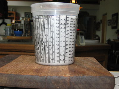

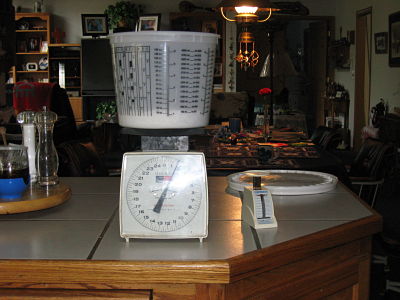

              Here are the pics for a visual of the potassium hydroxide being dry weighed into disposable measuring cups. I use these type tubs cause they are first cheap, the potassium does not effect the plastic but will eventually remove the ink so you can no longer read the increments but no big deal as they are cheap enough I can live with that expense. Potassium at this purity level will etch glass once it gets moist and sits on the glass awhile. Using the households glass measuring cups therefor might get you into some trouble and be more expensive to replace once the ink etching is no longer usable. After each use even with the plastic throw away type you want to rinse them out well with fresh water and then dry with a towel as the remaining flakes and dust will attract moisture out of the air in a matter of less than a minute, and will then be a concentrated simi-liquid highly corrosive base that will cause the next use for the potassium to stick to it more readily creating a build up. Another option would be to simply seal it in the same bucket you keep the potassium in and keep it air tight, this is the method I generally use, but even then still have to rinse them out occasionally.
              If you still want to weigh out each batch you can, but remember any potassium dust on your scales and if not cleaned off will be corrosive to them. So you will want to clean them well after each use. This is why I use the eyeball it dry ounce method here.

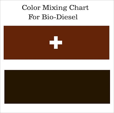

                    Color Chart for mixing Methyl Hydroxide
                    I made up a quick color comparison to follow while mixing the methyl hydroxide into the heated oil. If after 5 minutes or so of mixing the color of the reaction should be a deep dark brown...almost looks black in fact. Now if the color of your reaction looks more like a rusty red brown color you will need to add some more potassium flakes to the mix until it changes to your dark brown color, but do this slowly a little at a time and take a mental note of how much more in dry ounces that you added. wait at least 5 minutes between adding more as the flakes must be totally melted and mixed before it will react.
                    A good system would be to add the same amount each time and keep tract of how many times you added more to know how much more you actually added. Then if you go back to the original amount and it happens again you can simply add the addition amount at one time and save a lot of time doing so. If you continue the third time with original amount to get the red color you can assume the rest of your oil stock for that batch will be the same and simply mix all the potassium at once into your methyl alcohol, thereby adjusting the formula.
                    I like using this method instead of the tartation tests normally taught by many bio diesel makers as its faster and I rarely have to adjust my formula, sometimes it does happen tho, but not that often.
                    Here is the color chart, the big PLUS SIGN + means to add potassium to the mix. When you see the color difference you will know it and now you will know what to do about it when you see it.
