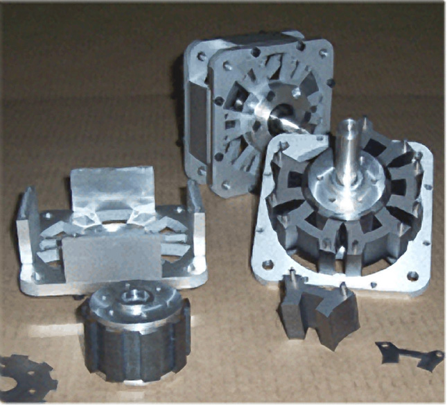

          I am rely glad to join on the forum.First sorry for my oful English, bat i tray to bee better .I follow this forum ,and finally join because off this trad. Thanks too Jetis for sharing as work on the motor. I work on this tape off motor around 2 years and still found some interesting behavior. First off oll mast say thet motor is not over-unity (sorry Jetis).In my case it s around 95 to 98% .But don't be discourage, I don't tray to capture BMF. Jetis work on 4 pole motor, mine is 8 pole and have some unique characteristic. First they have big torque inn opposite off switching reluctance motor, and torque is constant for almost ol rpm range. Second in range of full rpm and half rpm (of course with load) the current draw not change I think Jetis will discover same thing in hes motor. Only thing I suggest is he must use less magnets because of saturation of iron.I think half size will be best. Jetis if you have any question about my work I be glad to answer

            Hi zhorv324
            I would be glad if you could post some pictures of your motor. I already knew that the current draw does not change when motor is loaded, I saw that in a video at peswiki site. What was the air gap between stator and rotor in your setup? Have you tested the motor on a load test stand? I am glad to have someone here that also has been working on this. Any additional info would be appreciated, especially pictures Can you tell me more about the saturation of the core? How do stronger magnets affect the performance of the motor? Does current draw increase?

            • #21
              I mast say my motor is hand made literally, only rotor is made by water cutting.Stator and windings is made by hands, and therefore air gap between stator and rotor is in bast case 0,5mm . if you have lass air gap motor characteristic go up. I try to put some picture of motor in fase of assembling. In you tube you may see my motor if you search, parallel path magnet motor(by fredofantastico).About saturation of iron, you mast understand in motor you have 3 flux combine, 2 magnets flux and 1 electromagnets and oll go to core of stator. I presume you use silicon steel and saturation is about 1,8T. If you sum oll 3 flux you cant overcome 1,8T, because after that point you mast use more current to overcome steel hysteresis
