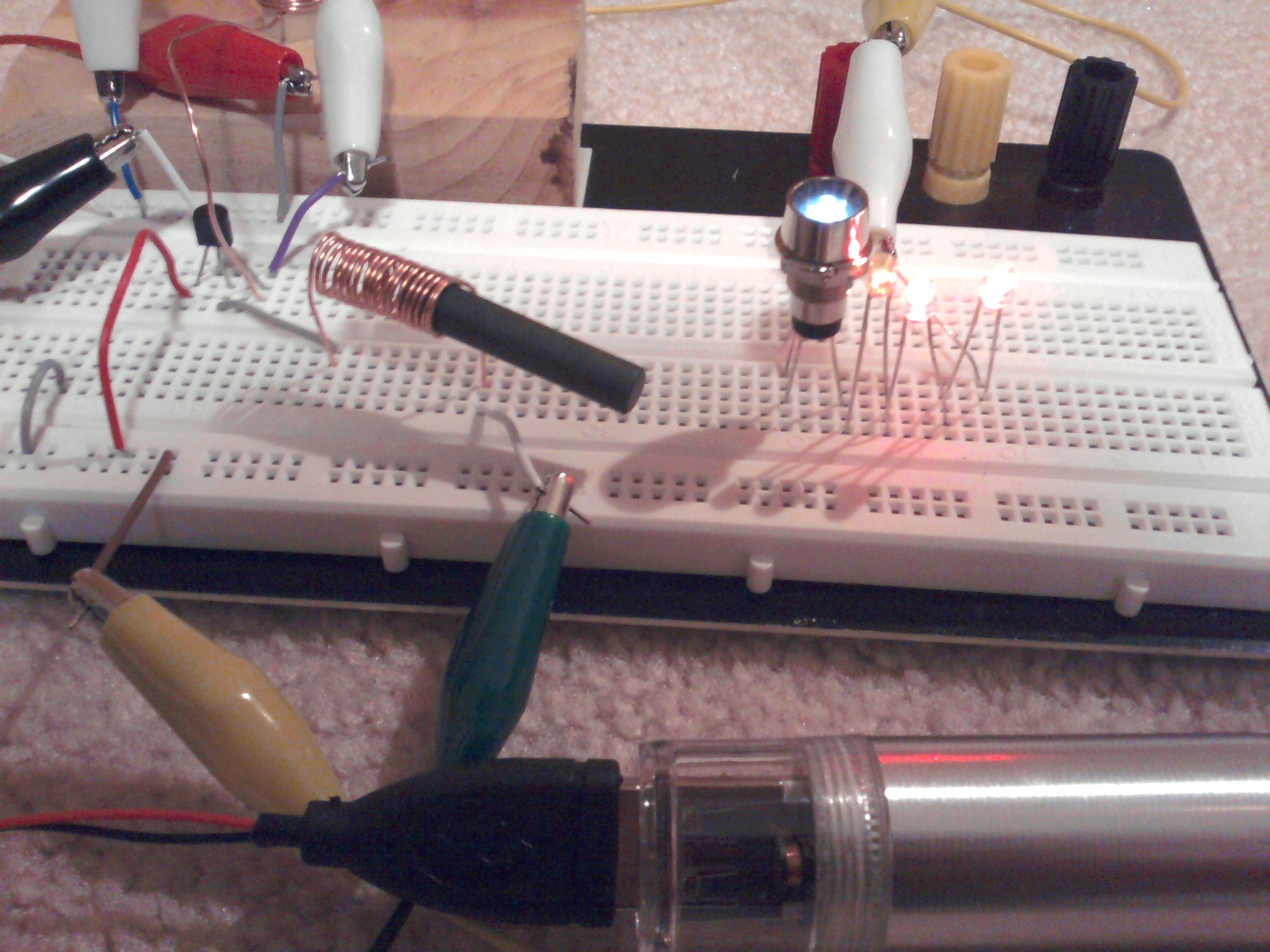

i just wanted to chime in as one of the people with lesser quality constructions that i got the exciter to work and im very happy with it lol..
i wound my tower thinking it was a waste of time, simply because it was scrapped degauss wire, and i actually ended up having to splice it together 3 or 4 times to get the extra length.. there were tiny kinks and crimps that just barely kept it from breaking the coating.. used a raggety 28awg for the L2 and to my surprise i was able to light a 40 watt floro tube brighter than i had ever seen it lit from a cell phone adapter.
with alot of help from cosmicgnarler (thanks bro=) i was able to get it going without too much stress. getting the L2 leads connected the right way is important.
simple exciter circuit but im using an mps2222 and a 1k pot, which allows me to tune it down to run from the AA. my "tray" is currently an old HD aluminum case. the LED's cohere from a good 3 inches away but only when i ground them with my body.
next step, more towers!

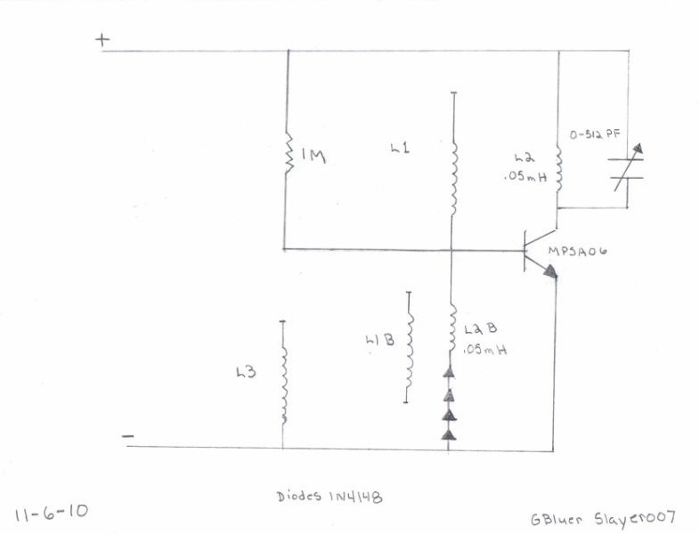

Hello Magneticitist
Welcome to the Forum.And thank you for posting your results.
Here is one simple mod you can try.Adding a second L2 coil comming off the negative side of the battery going thru the switching diodes and back to the transistor base.
You don't have to use the second L1 coil with it.But the output is a little better with it.
You can also make a lot bigger pancakecoil and just set it on top of the second L2 coil.
The L2b coil should be the same size as the first L2 coil.
When using this just try it just off one AA battery first.
You will notice the output from the one AA battery is close to the output from a 6v battery.
YouTube - Exciter With Second Coil And Tower Update.
thanks i will try that. tracking down some more wire.
im noticing how the different L2 arrangements affect the distance of coherence. also some variations will kill the oscillation when i touch the L1 wire and some will make the lights brighter when i touch it. very trial and error so far.
it is still amazing though how the voltage potential between the two wires supersedes the current wanting to flow freely through the transistor..

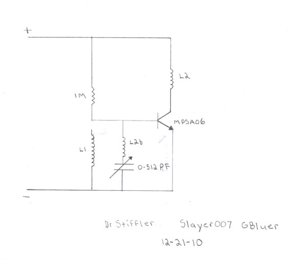

Ricksl the circuit your using you should use bigger coils.
I know some people have it running on small coils but it is very hard to get it going with small coils.
But here is another circuit that will work very good with smaller coils.
This one is kinda a Stiffler Slayer hybrid.
I just put this togeather with a few coils I had sitting around.It should work better with a little variation.
Also I haven't tried any coils off the collector yet.
Here is a video of it.
YouTube - Stiffler Slayer Exciter

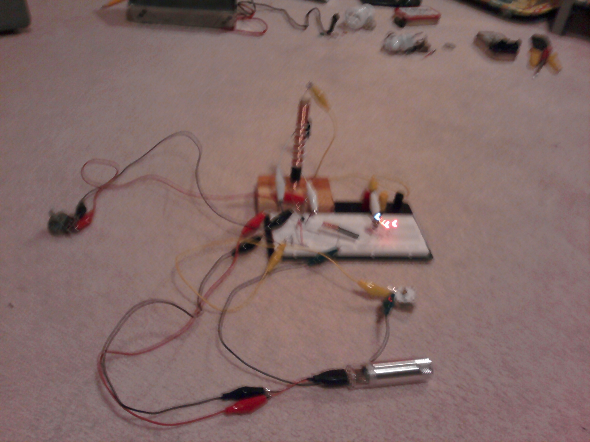

well ill be dahmed that configuration made it work
unfortunately i had no tunable capacitors with that value and i used one i found laying around with an unknown value. it worked but only with a potentiometer with like 20 k ohms or something like that and getting both of them in that sweet spot is a drag. especially considering every time i would tune the variable cap i use my hands and i guess my parasitic capacitance screwed it up
but i got it working and considering it lit up several series leds with only a 15 milli amp draw is pretty sweet. -using AA cell phone charger-
Originally posted by ricksl View Postwell ill be dahmed that configuration made it work

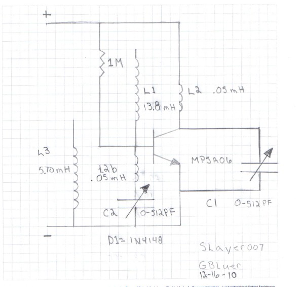

Thats Great news Ricksl
But when you get a chance to wind some big coils try the circuit in post #1432.
it turns out it lights just as well off of the collector of the transistor and for me oddly enough it requires no or limited additional tuning from when it was connected to the emitter... weird
i can't get the multiple sweet spot thing though. Other than that I get the same effects detailed in your vid with not really making a field off of the inductor tower, have yet to try a top load (i think thats what the metal piece is called forgive my being new to this). anyway just kind of a replication of your vid. the fact that the cell phone charger light dosn't come on is an indication that amp draws are very low.Last edited by ricksl; 12-24-2010, 07:19 PM.
i hear u about the coil winding... but i got good results making a similar sized tower, but with a larger diameter, and used about 40awg with close to 400 turns. main trick i use to test the oscillation strength is to tap the B and C to kickstart it with a spike. it will either flash or stay on. or wont, which means you are not even in the ballpark.
