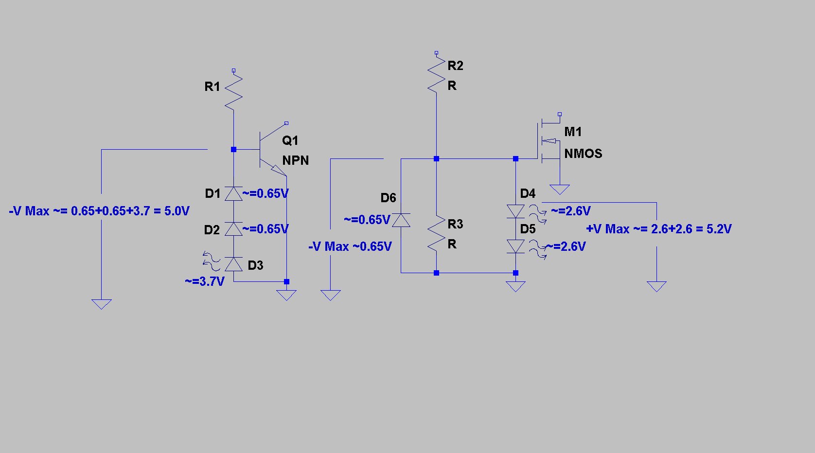

So perhaps one small shematic with the right component ,to start right would be apreciated. Or perhaps where i could get it ?
