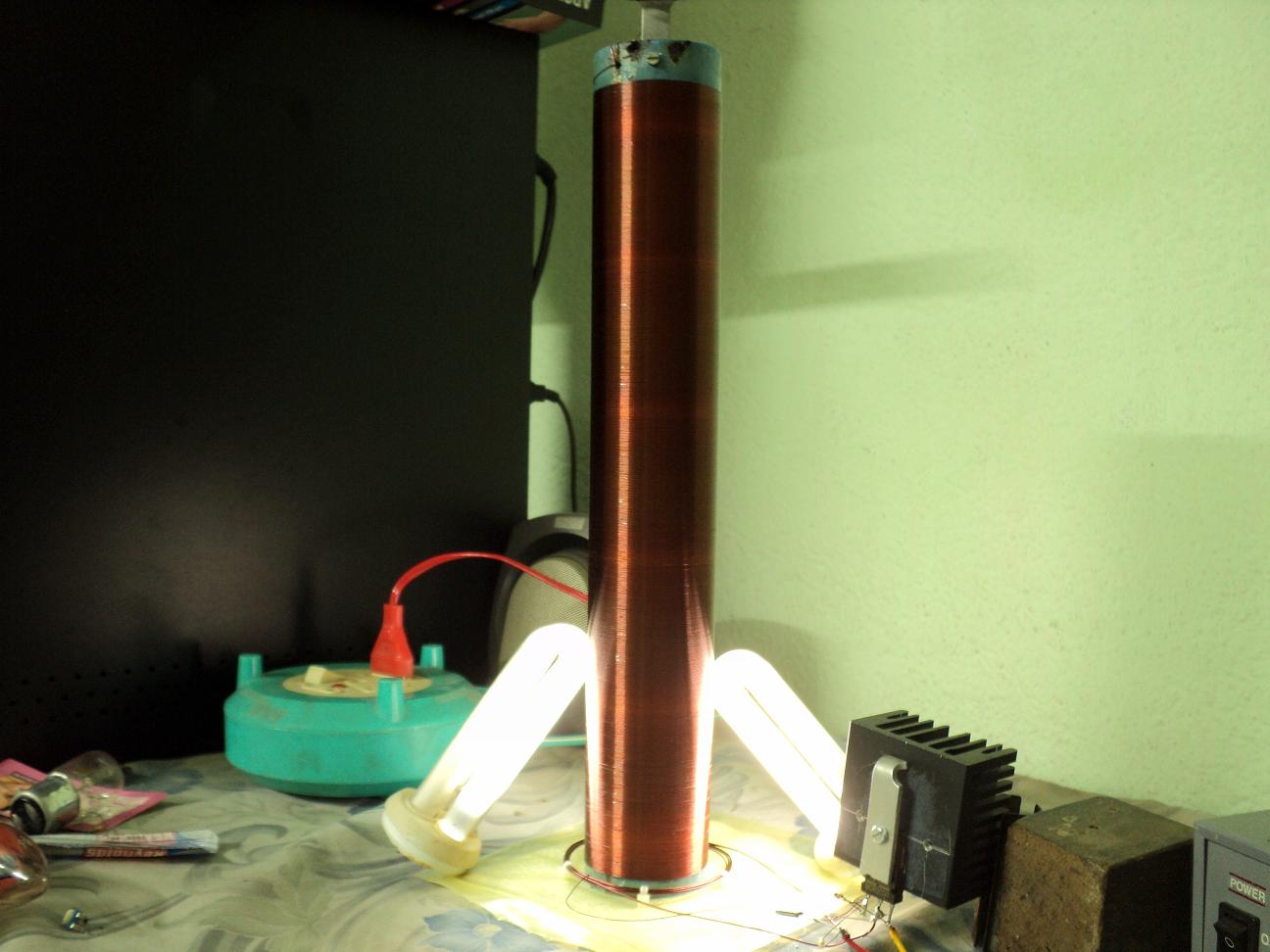

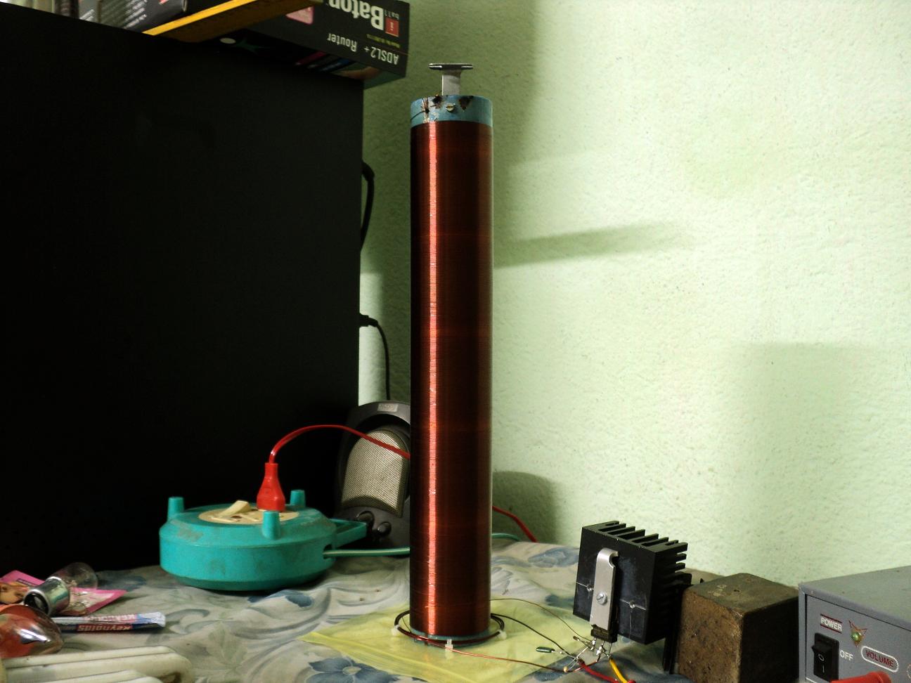

  • My First LARGE Slayer Exciter. Running smoothly.

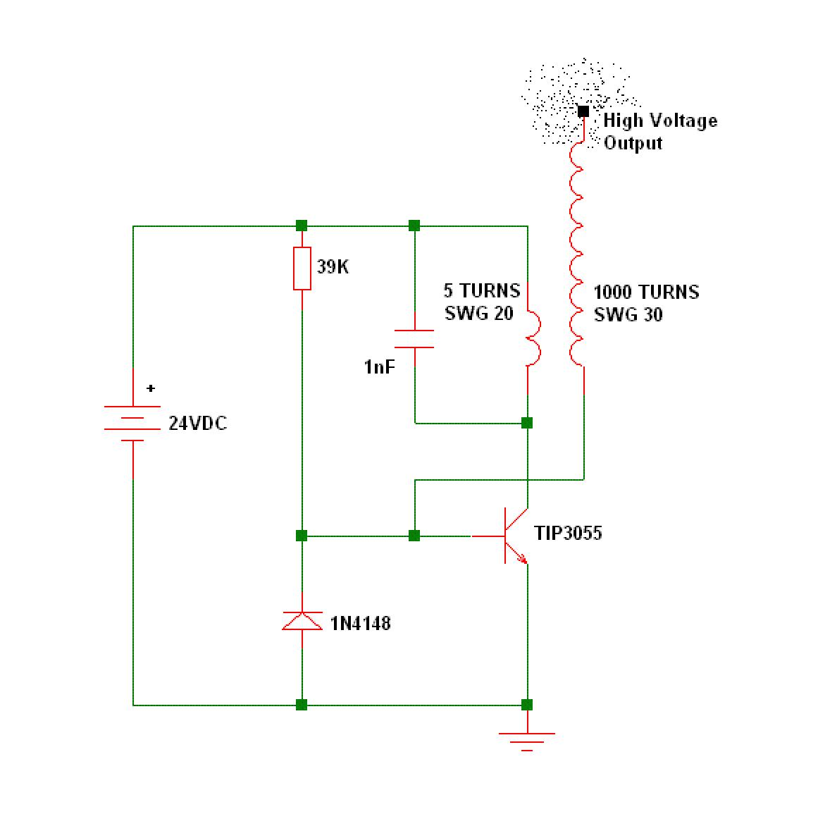

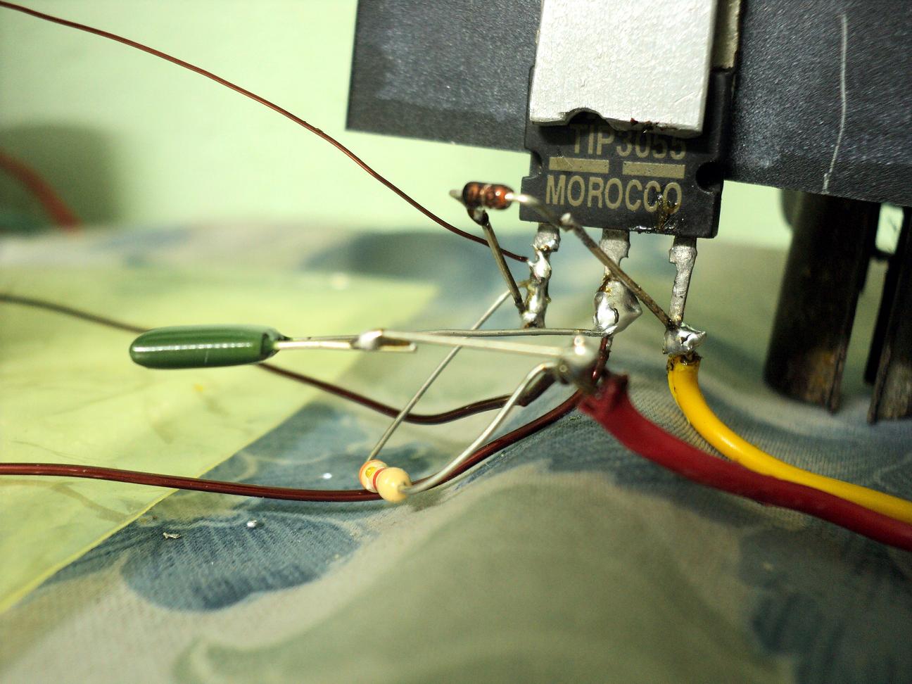

    Details:-
    Power supply:- 24VDC
    Transistor:- TIP3055
    Resistor:- 39K
    Diode:- 1N4148
    Capacitor:- 1nF
    Primary turns:- 5

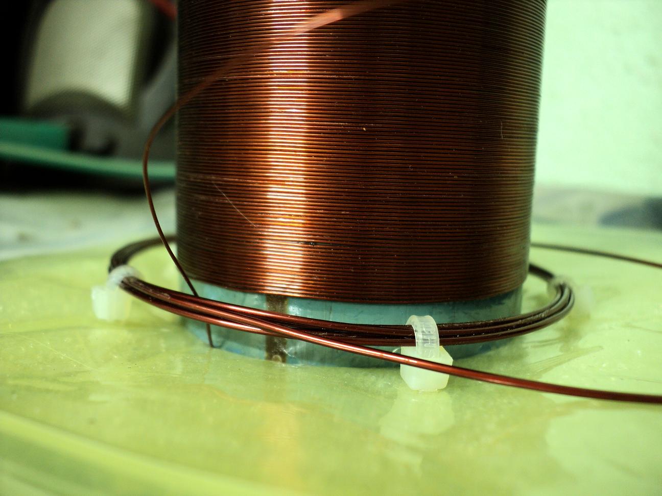

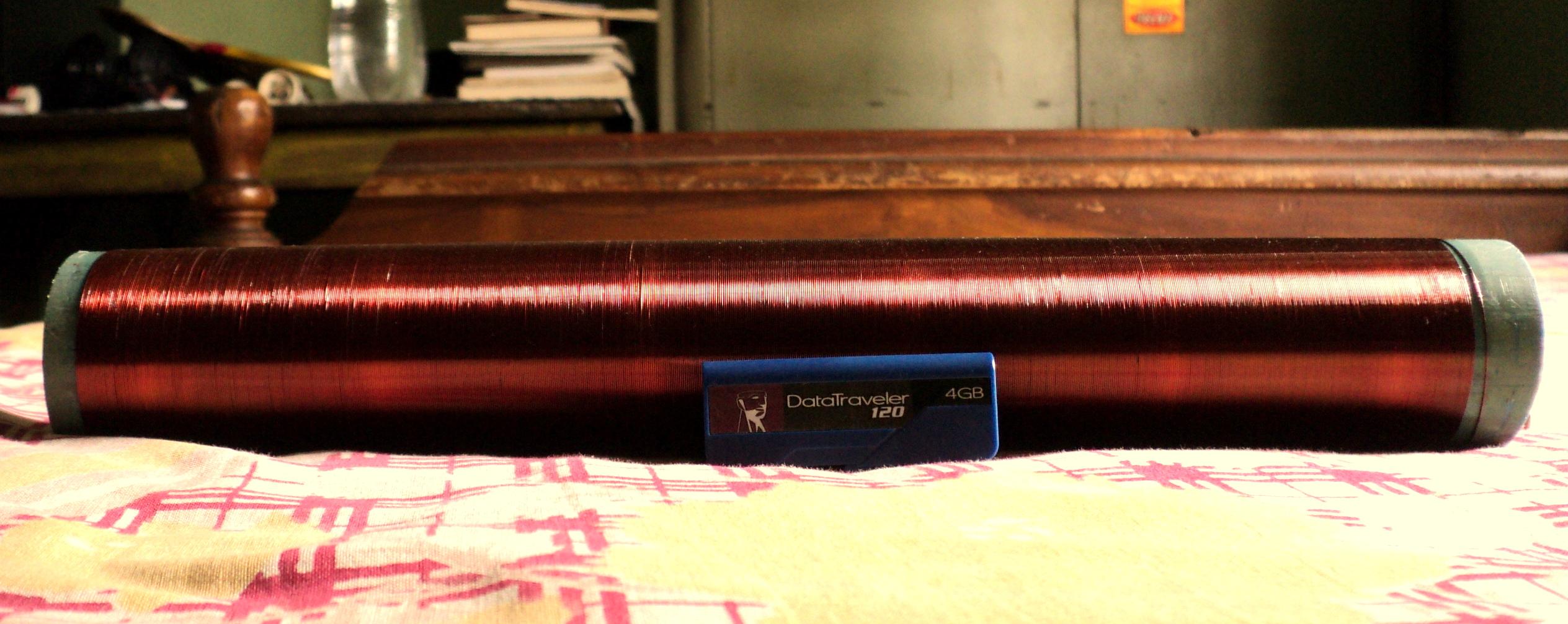

    Secondary turns:- ~1000 (probably more than that, didn't count lol. The secondary was hand-wound; took 3 hours to complete! Completely rewarding... see the pictures.)

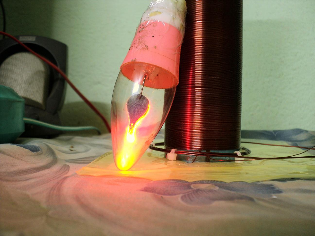

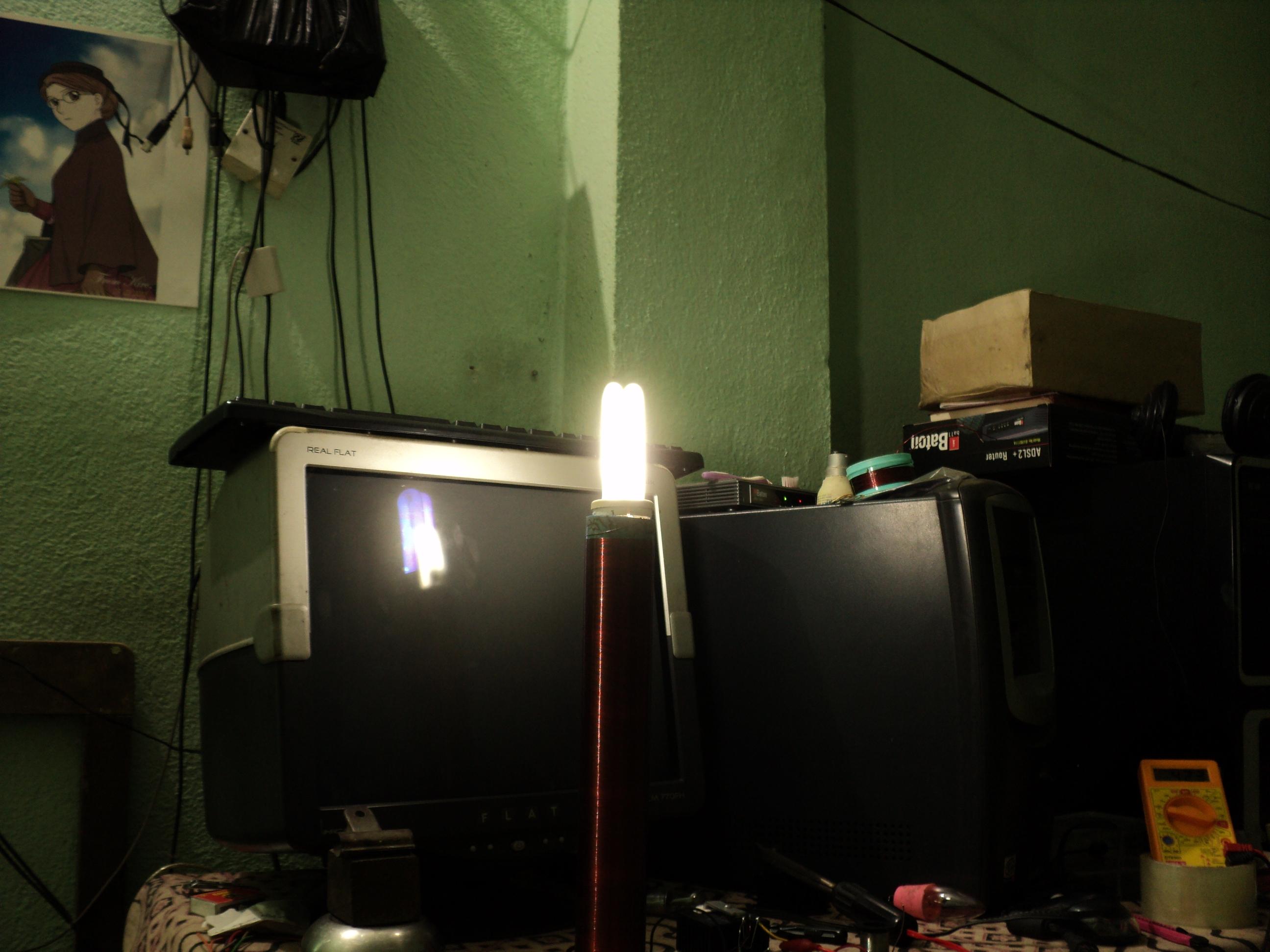

    The secondary produces 1cm long plasma when sharp needle is placed over the secondary. Lights CFLs 30cm far from the secondary. I was totally surpised/shocked when it lit the CFLs for the first time, on my first try! That was with BC548 transistor. It died after 10 seconds or so on 9VDC.
    This coil and the ghostly lighting of CFLs has become very popular among my family and friends! They all looked at it like "WHA DDA!" the first time I showed it to them.
    I am uploading a video of it. Will post the link later.
    Thanks everybody here! love...

                Thank you all for the kind words. Here are the coil dimensions:-
                Primary:
                SWG- 20
                Turns- 5
                Diameter- 6.5cm
                Secondary:
                SWG- 30
                Turns- 1000
                Diameter- 4.5cm
                Length- 33cm
                The coil will run with almost any NPN transistor. But with TO92 devices the maximum supply voltage must not exceed 3V. Otherwise the BJT will run into RIP mode.
                I plan to build a full fledged tesla coil from the secondary. Not satisfied with just 1cm plasma!

                        • For the last couple of days I have been playing with the exciter and experimented with various turns in the primary coil. All at the same diameter of 6.5cm. Resistor value is 100K. Results below:
                          @15 turns:
                          Minimum required supply voltage for turn on - 4volt. So a small transistor will probably work here.
                          Low current draw from power supply; transistor runs cool.
                          CFLs light evenly through the length of the tower.
                          Maximum CFL lighting distance - 15cm.
                          No plasma, but small and extremely bright spark when grounded wire touches the top of the tower (without sound).
                          5 turns(default):
                          Minimum required supply voltage for turn on - 9volt.
                          Medium current draw from power supply; transistor runs warm.
                          CFLs light upto 30cm away from the tower.
                          Minimum lighting distance - 3cm from tower, CFLs turn off if closer than this or touches the tower.
                          Most energy intensity at the middle of tower.
                          1cm long plasma to gounded wire. Sparks with sound.
                          3 turns:
                          Minimum required supply voltage for turn on - 12volt.
                          High current draw from power supply; transistor runs pretty hot.
                          CFLs light upto 60cm away from the tower(with 24V power supply)! Also many lights can be lit at once.
                          Minimum lighting distance - 10cm from tower, CFLs start to blink at ~10Hz and turn off if too close.
                          Most energy intensity at the Top of tower.
                          3cm long plasma to gounded wire. Very bright sparks when grounded wire touches top of the tower. No sound.
                          No insulator is an insulator! Current flows throught 5mm PVC/plastic and makes thin lanes of burnt plastic. The build-up of these black lanes can be easily seen. Looks like a tiny star is slowly walking over the plastic leaving a black trail behind. This is extremely funny and interesting. The top of the PVC pipe now has many random black lines, as if drawn with a pencil.
                          2 turns:
                          Nothing happens! No current draw. Probably too low inductance to start an oscillation.
                          Cheers...
                          shaan

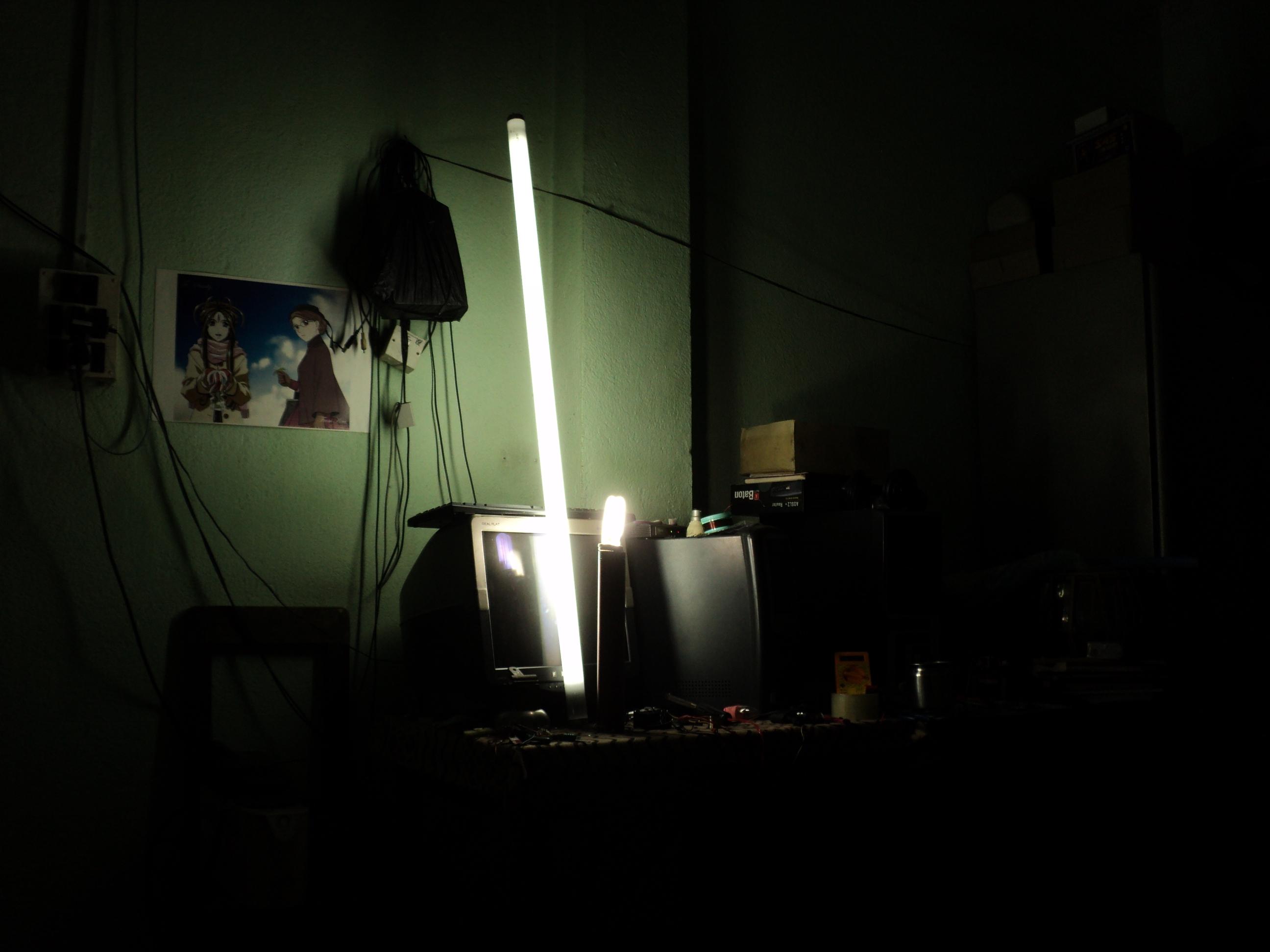

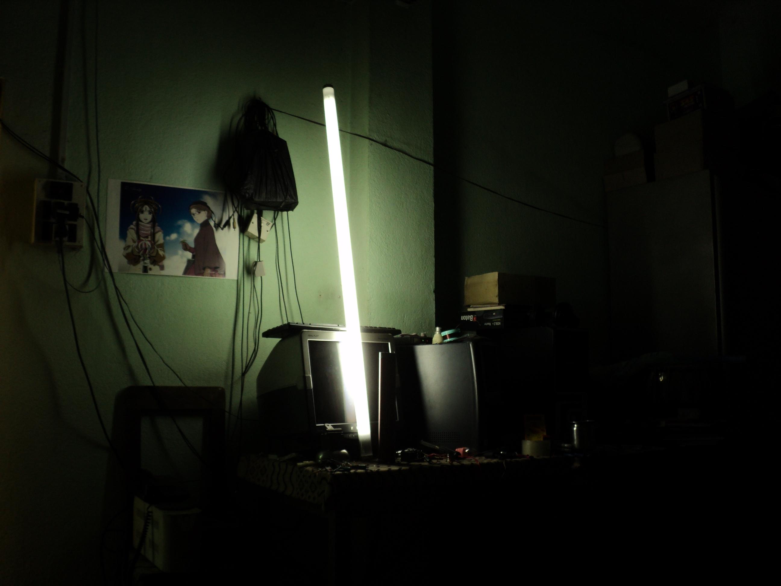

                              • Lookie Lookie
                                36volt @ 300mA Input from HP printer power supply. 15 turns primary. BJT - TIP3055. Ligting radius 1metre !!!!! Lights 4feet flourescents quite bright!!!
