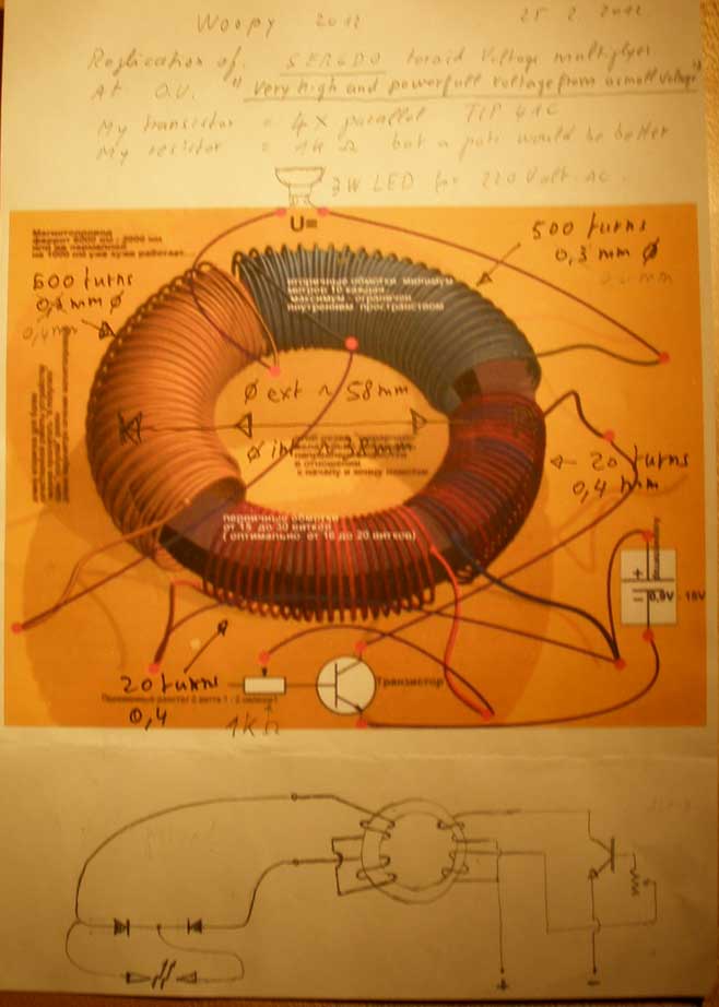

Probably nothing new here, and if I've left out thanks, I apologize to whoever may have invented this - but - just a peek at how I set up my 21" 48V.
Very experimental, a ways to go yet. Very high output. Not so terribly efficient mind you.
So i decided to rewind the 2 secondaries with 0.4 mm copper wire. Now i have a DC resistor of 4 ohms on each secondary, and i can already melt at less than 9 volt.
