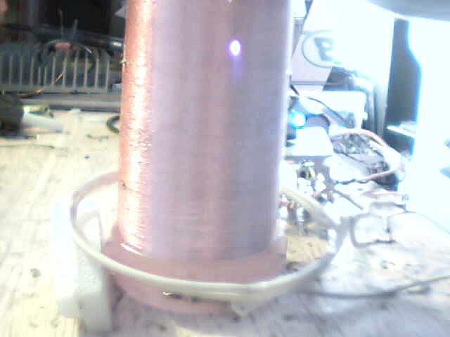

I'll get a good close up pic of one of the towers (wound 4 of them now) to show everything.
L1 is approx 400 turns of mid 30's enamelled wire from 2x RF-300 or RF-310 Mabuchi motors.
L2 can be either 2 turns or 3 turns of 'bell wire', which is, I believe, 22 guage. The spool the wire comes from does have a sticker on it, but someone in their wisdom decided to test a Sharpie over the label ! It appears to be of the same gauge as .032" Rosin Core solder from Radio Shack.

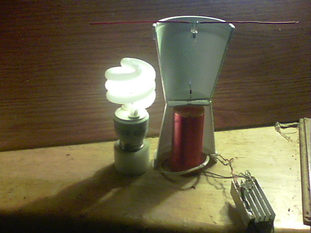

The L2 coil placement does affect performance. Likewise, there is a massive difference depending upon transistor used, Known plasma producers include MPSA06, HN2222A, C3242A and C3198. Many others will produce good plasma if ones finger nears the output wire end.
