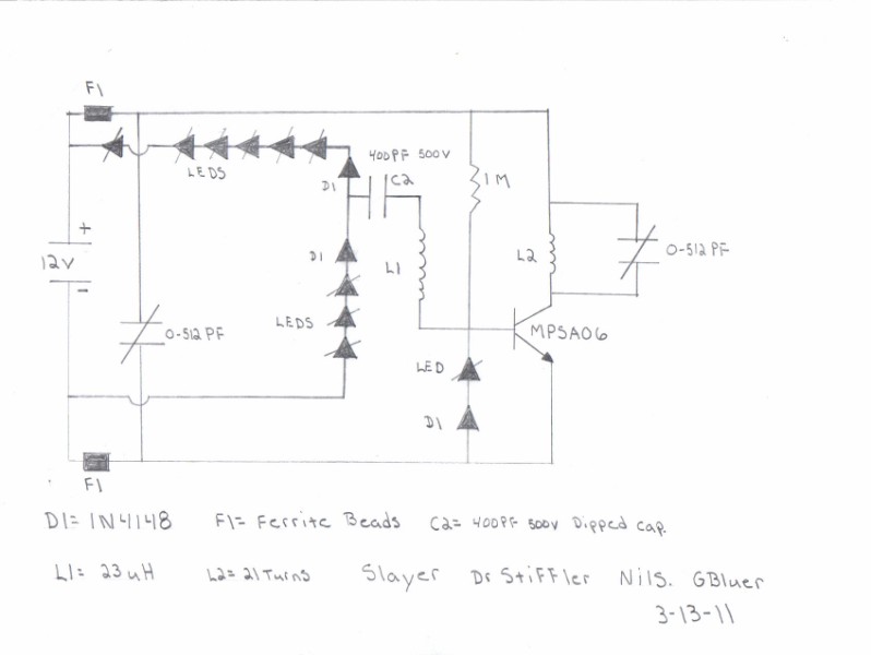

Circuit of jonnydavro
Thanks jonnydavro, i will try your ideas with the circuit. Today I am doing some winding with a ferrite toroid. I use the wire from the Am radio loopstick antenna. 165 turns of L1. L2a and L2b the same number of turns (17 turns). The circuit did not fire up. No oscillation. I reversed back to the loopstick version.
Have not tried the capacitor and 1N4148 option. But tried using different transistors, and the TIP3055 did performed the best at this moment. Still only get the CFL partially lit.
Tomorrow I will tried the Totoala idea and the variable cap across the power source idea from Slayer.
Thank you all for the great ideas!

. I've been working with rodin coils the last 4 or 5 months and I wondered if anyone had tried using one in an exciter circuit. Also I've watching @lidmotor s last vid on the slayer today just finished building a circuit but then realised it's a bifilar coil doh!
