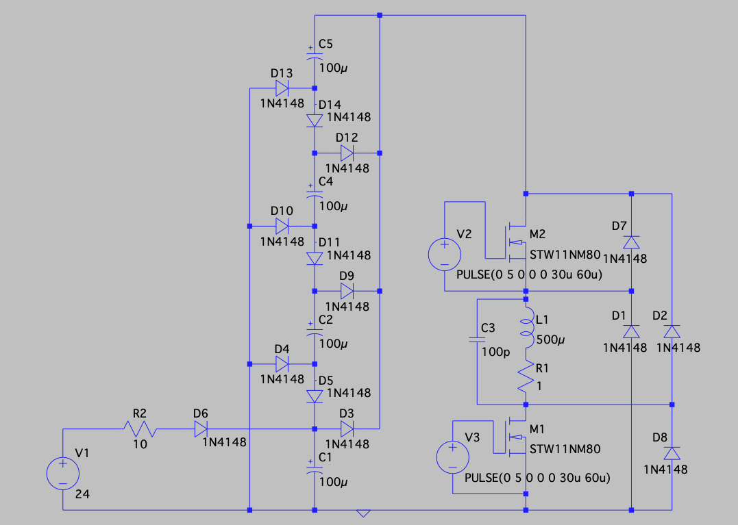

Now let's take a look at how brushless DC motors are typically controlled, the asymetric bridge converter:
What is interesting is that this essentially the same circuit as Bedini uses, albeit for three rather than one coil or "phase", with the crucial difference that in this case both the high as well as the low side (of the coil) are being switched. This way, two recovery diodes can be used instead of one and thus the "loop can be closed" and the BEMF can be captured in the capacitor without shortcutting the coil.
What is also interesting is that with the use of a couple of diodes, we can make it so that a number of capacitors (or batteries) can be discharged in parallel, while being charged (by the BEMF) in series:

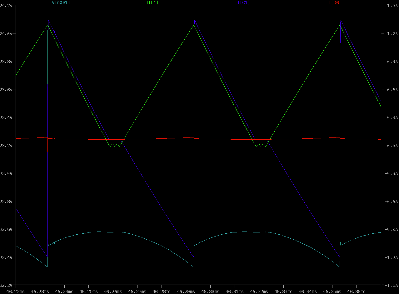

First, I simulated a conventional circuit with one coil ("phase"):
I plotted the current through the coil, the capacitor and the diode from the power supply as well as the voltage over the capacitor:
The green line is the current trough the coil and as we can see, it charges and discharges in about the same time this way. The light blue line is the voltage over the capacitor, which shows a sudden jump at the time the transistors are switched off, whereby the current through the cap rapidly reverses in direction.

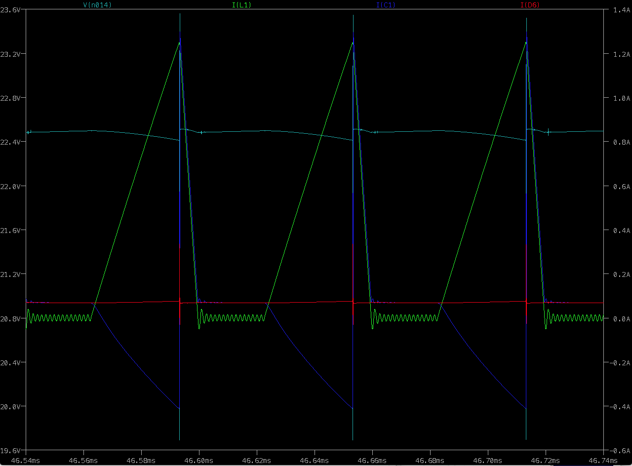

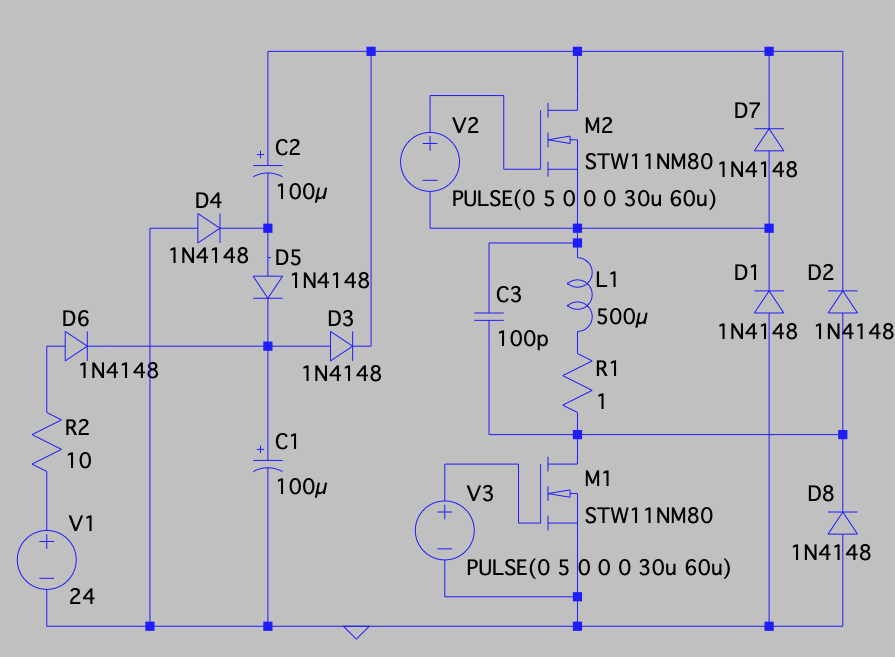

Now the situation with a cap bank with two capacitors:
And the result:
As we can see, now the coil discharges it's BEMF quite a lot faster, which improves further by adding more caps & diodes:
And the result:
As we can see, this results in the coil discharging (it's BEMF) even faster.
And the result:
And the result:
